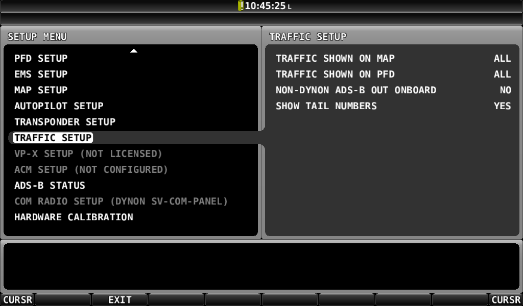

[/img]]I am still having problem making the SL30 and the Skyview communicate.  It seems wrong that the Com selection is grayed out in this attempt, am I correct?

That selection is if you are using the optional Dynon radio.
As skydiver says that menu is only for configuring our radio (mic gain, volume, etc).
With an SL-30 your only choice is in the Local display setup->TOP BAR where you choose if the status is shown.
