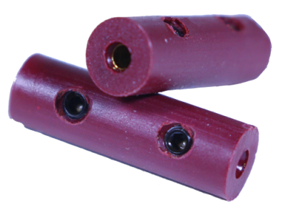

I have posted these before, but it has been a while. I had all sorts of trouble with the Dynon provided connectors, and finally went to what I used professionally years ago (non-aircraft). They can be purchased from Omega Engineering, are about $4 each, and are reusable, and quick connect/disconnect. They are specifically made for thermocouples. They are about 1/2" wide. One of the best mods I've ever done. Zero thermocouple/connector issues since conversion. https://www.omega.com/en-us/search/?text=SMPW-CC-K-M
