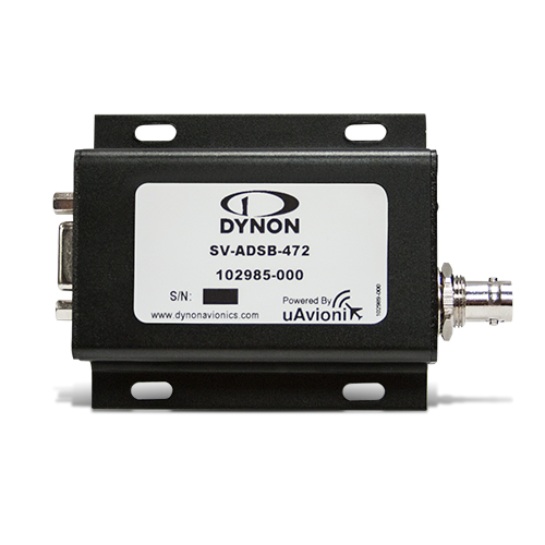

It is displayed on the map and optionally on the PFD via the SV-ADSB-472 ADS-B IN DUAL CHANNEL RECEIVER. The WiFi dongle will allow viewing of traffic and WX on compatible portable devices/apps.

I have been flying for the past year plus a Dynon HDX plus the SV 472 and it has worked great. The last couple of flights I have had an issue where the ADS-B in has disconnected a few times in flight. It is normally not long but it is disconnecting and showing me no traffic where I know there is some. Has anyone else experienced this problem?
