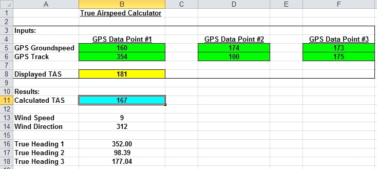

I have not recorded any changes in IAS with the amount of tape, I was focused on the indicator and what is was or was not doing. I'll check on the altitude via a ILS, good idea. Attached is a spreadsheet of two runs I did today. Same course, 3000 msl, 30.00", 24.5/2450 on the power settings. Still scratching my head. What do you see?

According to the numbers you posted I calculated your TAS to be 167Kts (for both runs) not the 181Kts you are displaying which agrees with what SUNFISH posted. This is a +14kt difference in EFIS calculated TAS to GPS only calculated TAS. Take the same measurements at a slow but stable speed (below 100Kts) and see what the numbers are.
I see you fly out of Quincy. I am in St. Augustine so if you want to, take a quick flight over here and we can do some extensive flight testing. Your problem has me curious.

Sounds like maybe a static error - too low air pressure artificially increasing indicated airspeed. Using your check ride.com calculator, to see a 168 TAS at 3000 ft, 30.00’ and about 12C, you should be seeing an IAS around 160 kias. You are showing an ias around 172.
....Anyway, I’m jealous! 160 knots is about twice as fast as me :)
