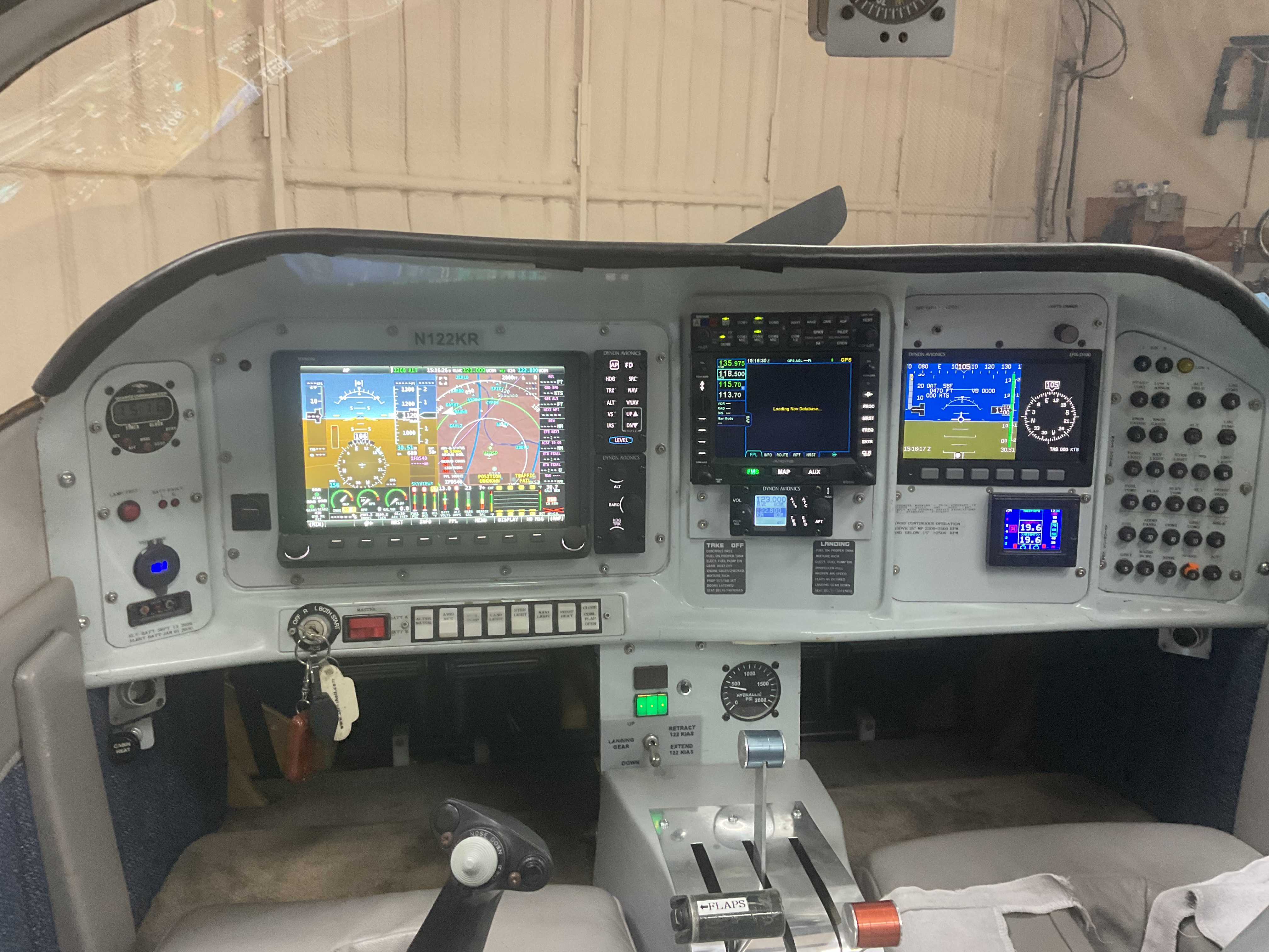

I assume you are looking for something like this panel. The Glasairs have been using these for 25+ Years. They are sold as the vision micro panel. It is made of fiberglass with aluminum inserts. I am sure you could find one for sale on the Glasair owners group or direct from Glasair. You will likely have to adjust the dimension to fit the RV. Also note the SFD (backup display-D-100) area is not wide enough to mount the small HDX-800. So, that area will have to be adjusted.

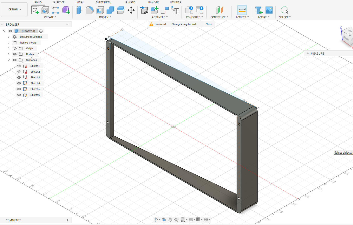

Something like this? This is for the HDX -1100, will tilt the display 1 inch.

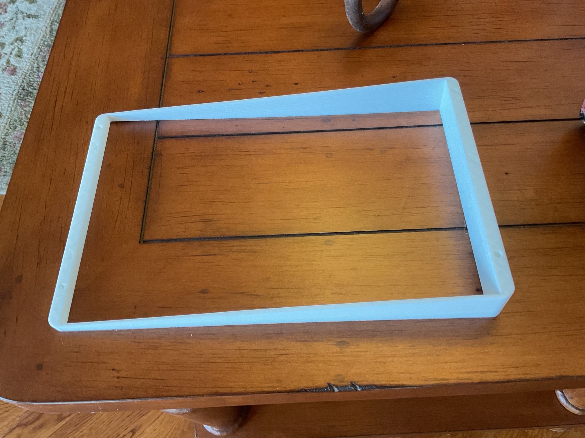

I printed out a sample in PLA. It looks pretty good, but I don't have a spare HDX-1100 to check for fit.

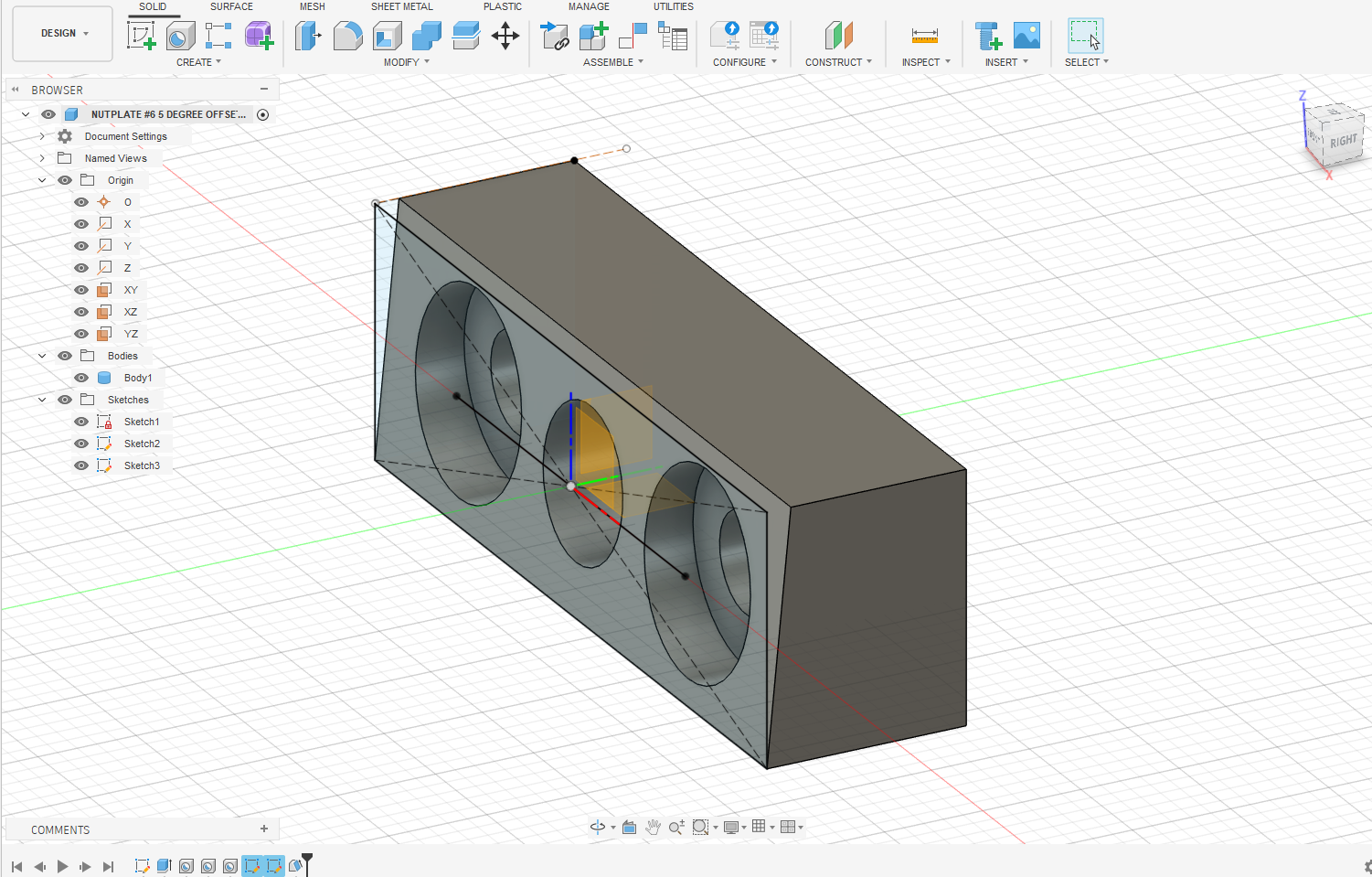

No problem. Here is some #6 nutplate shims set at the panel / screw angle. I counter bored the hole sou you can mount the nutplate on backside with pop rivets or universal head soft alum rivets. you would apply some kinda contact cement to these on first install so they would not fall out when you later remove the display.
