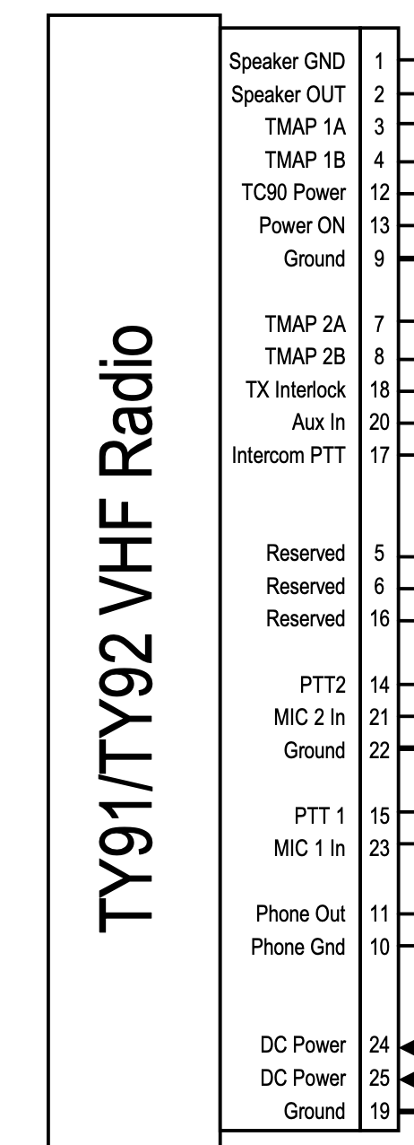

Excellent point, well made. It would be very nice if those RS232 inputs were as you've shown. Maybe they were not on the diagram I pasted because they are just not used in a normal radio set up. I agree that Pin 5 and a ground may well allow the Bluetooth dongle to do its job. Only one real way to find out :)
Looking at the HDX wiring diagram documentation, it shows pins 5&6 being used as data Tx & Rx from the SVCom Panel. It’s possible that the com panel is basically the same as the TC90, just packaged differently.

On reviewing the Dynon installation manual for 3rd party devices it looks like the HDX screen RS232 interface uses standard NMEA 0183 protocols that match the output from SkyDemon so it should work with no issue. If you're using the BLE module to connect to the AP as well you would need to reconfigure the baud rate to 9600 as per the TY91 installation documentation below.
It looks like everything aligns... and if the weather wasn't so dire here I'd go to the airfield and investigate.
