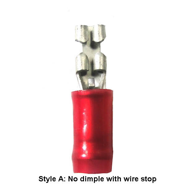

Replace the spade connectors. This is the problem more often than a probe going bad. You can get them at Aircraft Spruce or Stein:
If memory serves, you want the 1/4” wide spade.
The wires are thin so I typically add a #22 wire along side the probe or EMS wire to fill in the connector.

Thanks for your reply. Already replaced connectors plus pulled wires from D-sub connector and, replace new D-sub pins. Open to any and all ideas!
