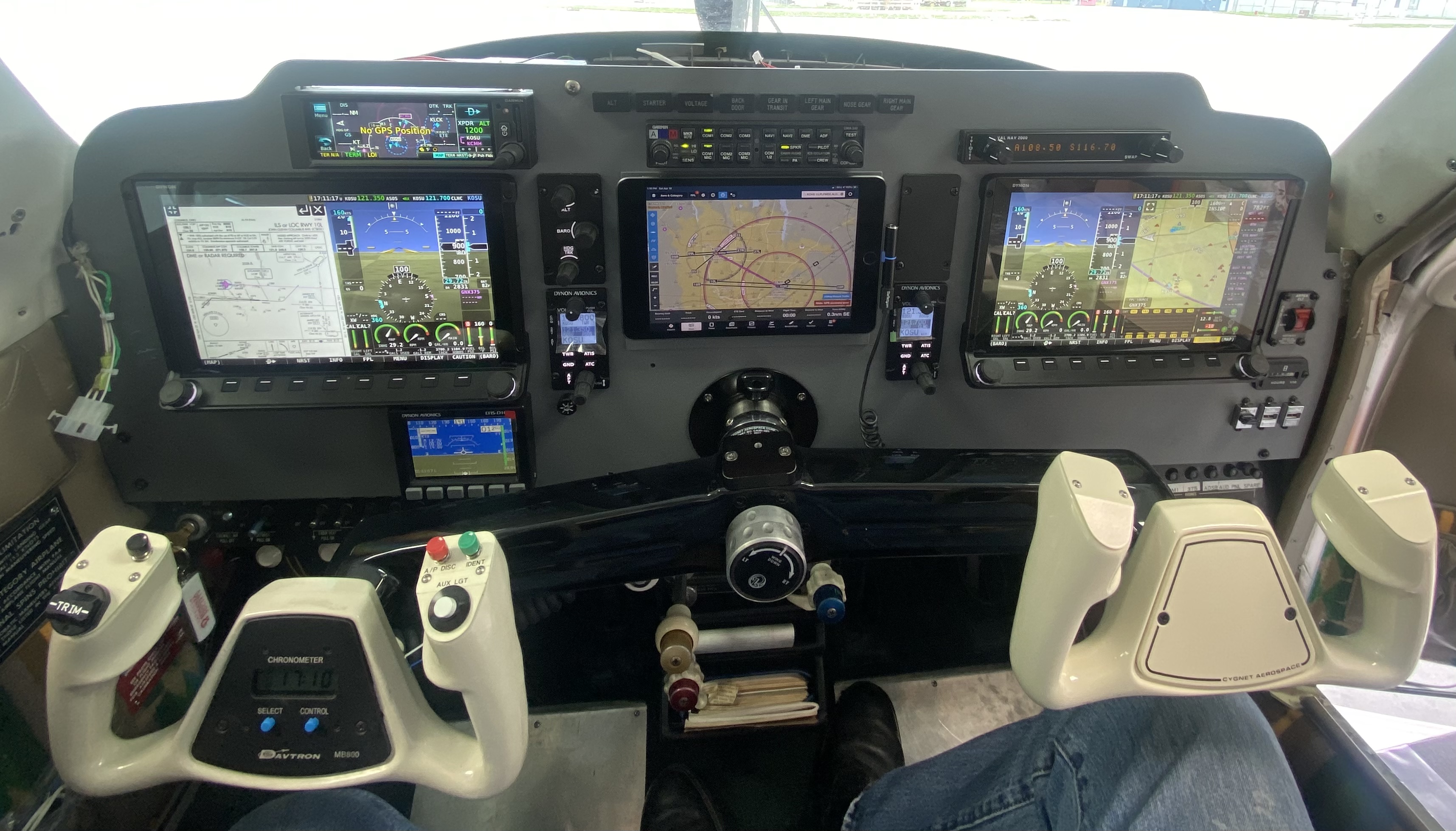

Accomplished my first flight with my HDX SYSTEM. Need to tweek some of the yellow/green/red ranges on engine instruments and get used to where some of the information is displayed - but it all worked! Swapped my two comm radios up to the higher position for better visibility. NEED THE AUTOPILOT to get approved so I can relax and study other tweaks that need to be made!

Nicely done!
You are going to love it.

That’s a beautiful panel! Can you control the Val nav radio from the dynon? I wish I had that sort of real estate.

No. Must tune VAL itself and adjust OBS with its knob. Wanted to use the VAL remote unit but Dynon (at the moment) only sends frequency to standby position with no means of flip-flopping the remote. Now that I think about it, maybe I can send freq to then VAL stby position from HDX - will have to try it!

I’m able to send and flip flop standby and active frequency’s to my GNC255 including Nav Channels from the Dynon.. have you tried selecting a nav channel from the info page that has Nav frequencies to select and tune that would at least make it a bit easer?
