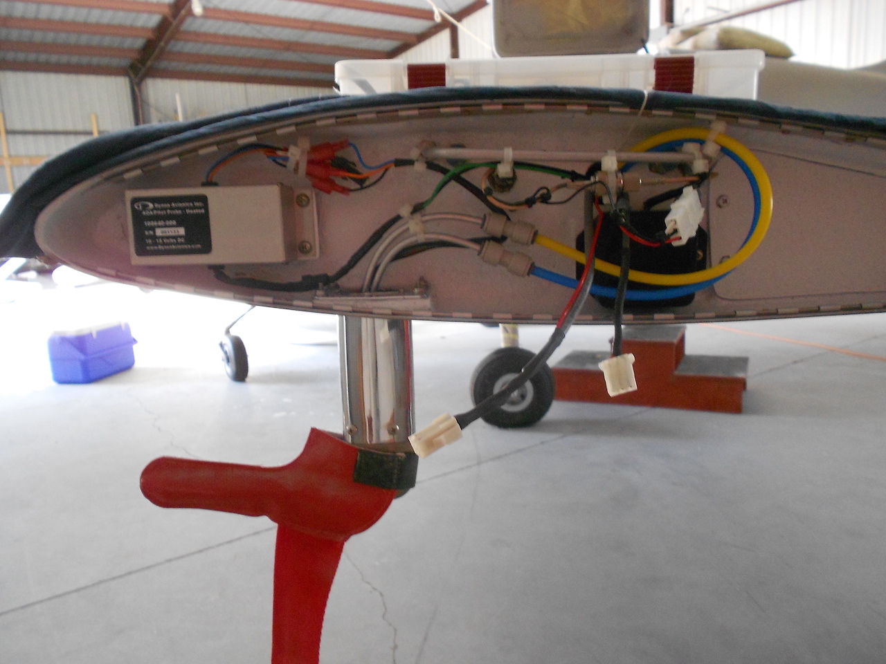

There are a number of ways to to do it, but it would be the same as any fiberglass composite wing.  I placed my PT at the wing tip as far out as possible.  As the wing structure is not flat in the forward position of the wing, I built up a pad of structural aerosil (resin and fused silica) so it had a flat base and was level for a normal cruise attitude, and as far forward as possible.  I use a PT mast that is inserted from the inside of the wing end, and then attached with screws through the bottom of the wing.  Using the mast makes it an easier install and helps alleviate any airflow disturbance issues around the wing.  Again, this is one of probably several ways, but hope this helps.

Thanks, Interesting and useful.
I have a Flight Design CTSW and am working with a wing already built. I have access through one hole. I have to build up a mount so am wondering how to embed the captured nuts. Just "glass them in"? Put them on some kind of frame and glass the frame in? I'm thinking out loud but appreciate the suggestions.
Mine is a heated pitot tube.

What Ray said. If you look at my first photo, the mount for the
PT controller is done just that way, except I used fiberglass flat stock instead of aluminum. However, I have aluminum plates with nut plates imbedded all over my plane.
