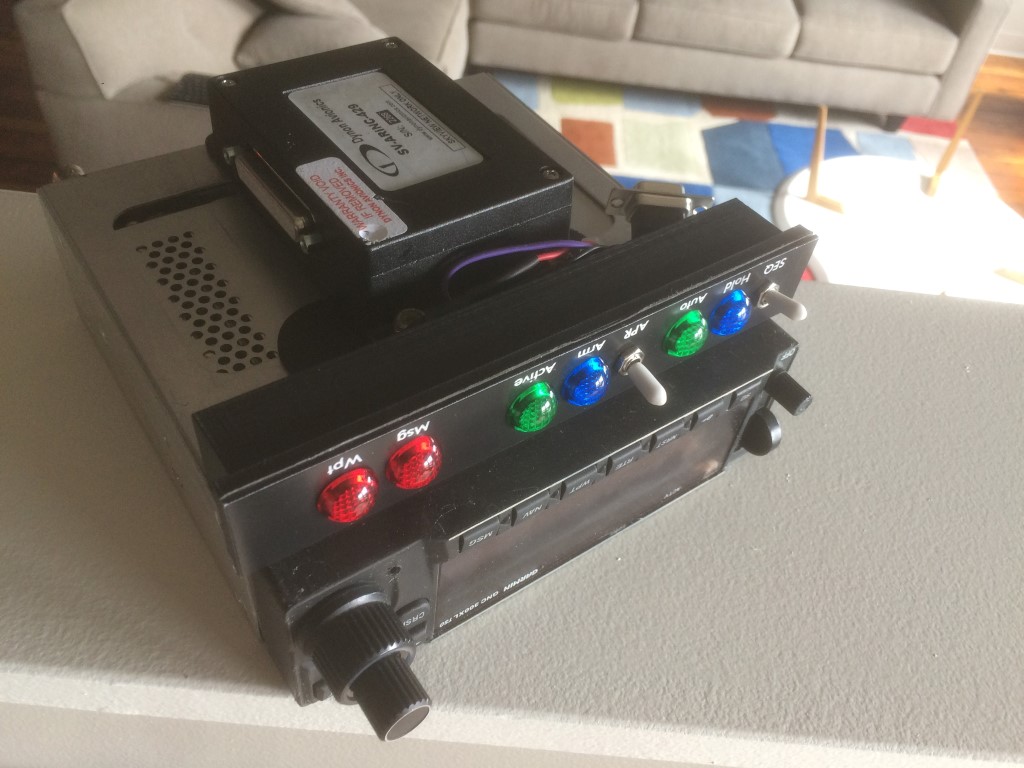

When it came to the annunciators, to be honest, I didn't know what an annunciator was for, but they're freaking expensive.  One that works with the 300XL is over $1000 used, and its just some switches and indicators.  So, I made my own.  Its pretty simple, there's a few switches that the 300XL needs (just open or ground), and it outputs a number of negative logic sources that can be used to drive lights or LED's to provide indications.
Here's the ones you need:
Don't need the NAV or GPS indictors or the NAV/GPS switch - Skyview allows you to select either the NAV or GPS source, and provides indication which you're using.
You need a switch for the Seq Hold function, and two LED's to show the SEQ and HOLD indications.
You need a GPS approach switch, and two LED's to indicate ARM and ACTIVE GPS modes.
Finally, you need two LED's to show the MSG and ARRIVAL indications.
I've attached a pic of the annunciator I used.  The wiring of the SEQ HOLD switch and SEQ and HOLD indicators is shown in the back of the 300XL installation manual.  The wiring of the other indicators is very straightforward, just supply +12V to one side of the indicator light, and wire the other to the 300XL (for example, the ARM GPS indicator goes to Pin 28 of the DB-37 connector).

Geoff, I'm looking to do something similar for a 300xl and your solution looks better than anything I've seen.  Where did you source the enclosure, lights and switches?  Do you have any pictures from the backside?
ggerhardt
Nov 18, 2010
54
Hi,
I 3D printed the enclosure for the lights/switches. I'd be happy to share the cad files with you, or, if you don't have access to a 3D printer, I can print one out for you. Send me a PM and we can figure something out.
Geoff
