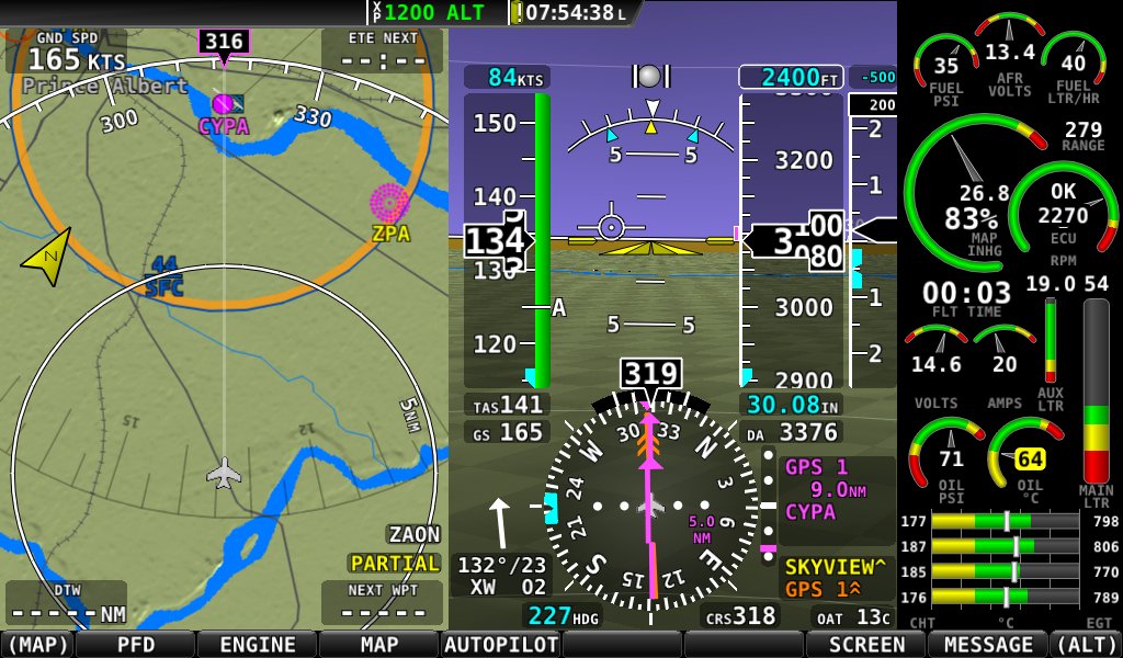

I believe there always has been vertical guidance if you have VNAV setup in settings. On the following screen shot the purple V in the vertical speed indicator will take you right to the altitude above the waypoint at the specified vertical speed that you have specified in the VNAV settings.
When I was using my GPS495 for NAV the vertical guidance appears next to the HSI.
I believe that as of the latest software, the VFR guidance to airports/runways is still expressed in terms of an overlay on the VSI. We'll be making a shift to showing it as a glidepath, but I don't think that was in 15.3.5.
Actually, it sounds like you're running the preview version that of 15.4.2 that technical support has available for people to test the fix for the loss of time/gps rollover issue. In that case, you're seeing some (very short) future behavior there that isn't documented (because it's not part of an official release).
