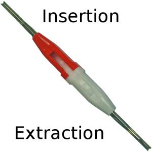

BAC - Just a quick correction on Hiroo's post. The green and white tool is for high density pins. The standard pin extractor is red and white. As previously stated, the pins are extracted from the back side of the connector. I think the metal tipped extractors are best, as the plastic ones get broken easier. I would suggest buying several in case of breakage. I have probably gone through three or four. Steinair is also a good source, and they have a variety of extractors for Molex and other type connectors.
