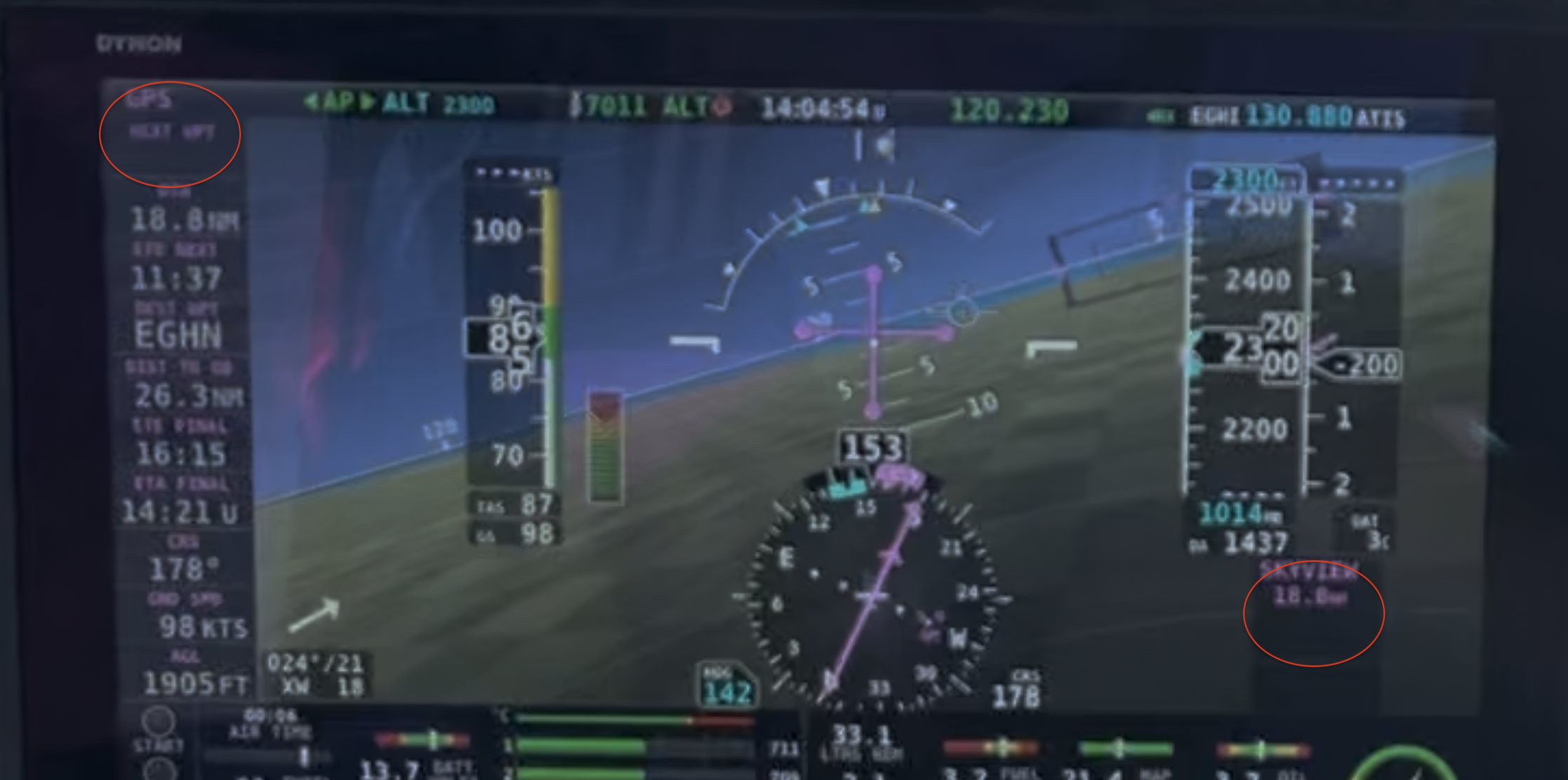

Skyview 17.4 bug?
Sorry the photo is not so clear but taken off a video.
On this occasion the route was transferred from SkyDemon, via the SkyView WIFI, to the HDX flight plan. Once airborne, NAV was engaged and the autopilot followed the route but there was no annunciation of the next waypoint in either of the red 'circled' areas.

You need to provide more data. What type of waypoint, for example? VOR? APT? User?
Just loaded 17.5. Did not fix the missing next waypoint.

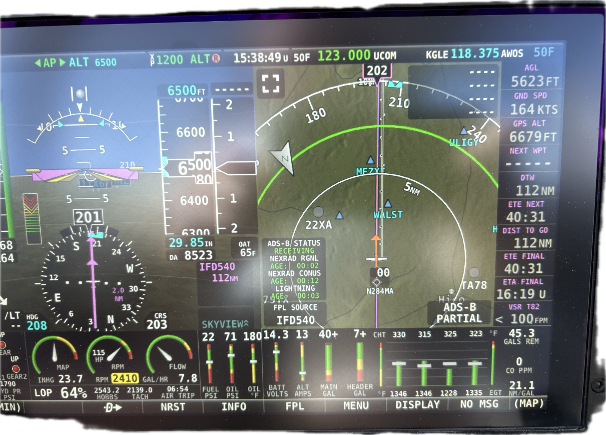

Yes. All next waypoints is missing on the hsi and on the customizable list if you have NEXT WPT in the list.
so, to see what you are navigating to you must either hit the FPL to view flight plan or go to your navigator and view the flight plan.
Yes. All next waypoints is missing on the hsi and on the customizable list if you have NEXT WPT in the list.View attachment 7132so, to see what you are navigating to you must either hit the FPL to view flight plan or go to your navigator and view the flight plan.
We are still working on running this one down, it's a weird bug and not all GTN/IFD customers are seeing it. Some have reverted back to an earlier version (17.1.0 and it seemed to resolve it for some, but not for all). We have diagnostic data from some customers that has been useful to the software team who is working on diagnosing and fixing it, if you haven't, please submit data after a flight via the link below to help us squash this one.
Early indications have pointed into garbage data coming over the ARINC stream from the NAV database that the external navigators are sending. Either a corrupted waypoint ID or simply a label that we deem as invalid (and maybe it isn't invalid). We're working on solving it though, I know it's frustrating..
