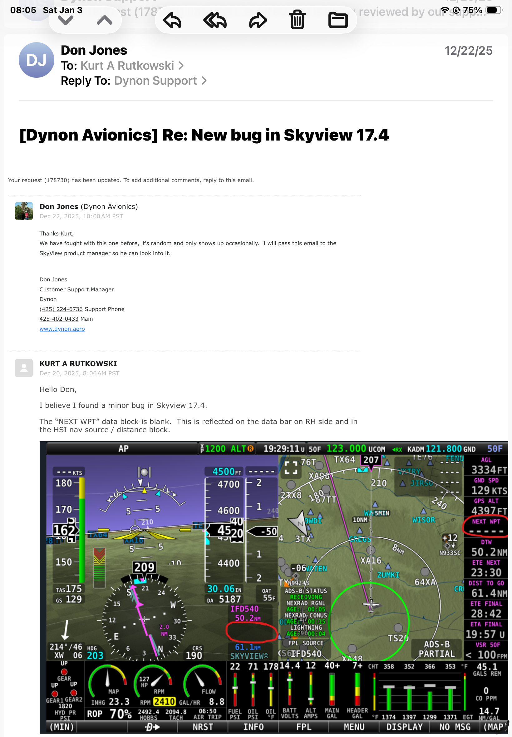

Dynon is aware of the bug. I did get a response back from Don at Dynon.
i suspect the holidays have delayed any real responses or work on this. Not sure exactly what he meant by being random, but i see this issue on every flight.

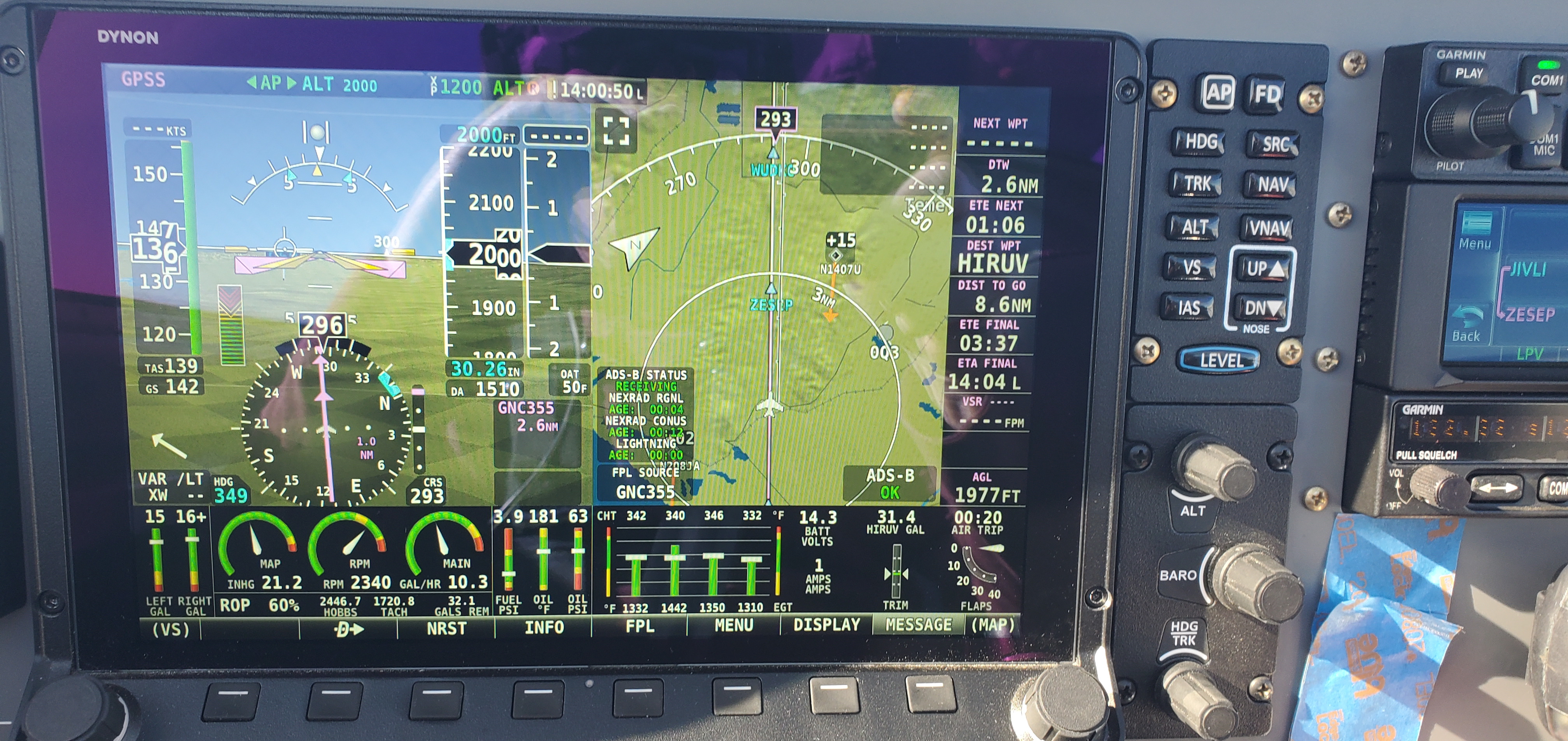

I'm experiencing this problem as well.
In the Pilot's User Guide, NEXT WAYPOINT is defined as:
NEXT WAYPOINT: The waypoint after the current active waypoint in the Flight Plan.
In the past on my HDX "NEXT WPT" was showing the current waypoint. Anyone else notice this?
I was flying the LPV29 approach into o69:

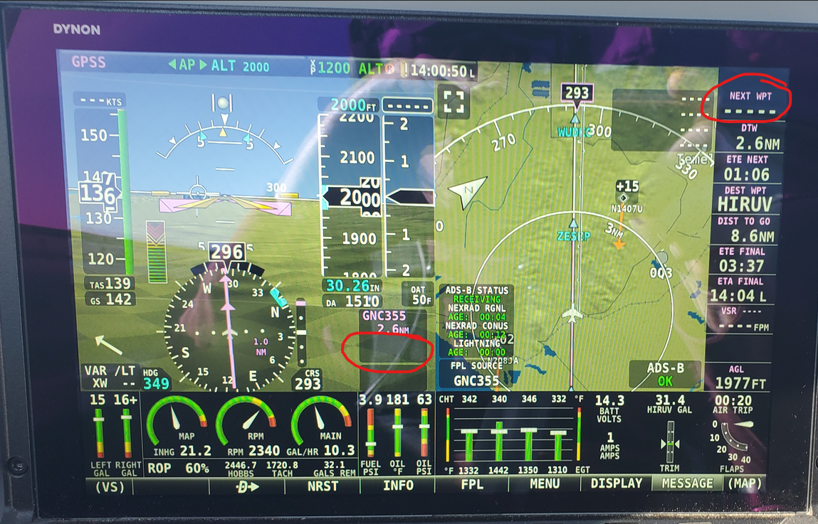

Yes- Dynon has been notified. It appears to be a problem when using an external navigator (ARINC 429).
You should notify Dynon so they realize how many people are impacted by this.
That field is also on your HSI display. See circled areas.

Hello all,
As noted above in the screenshot that was shared, we are aware of this popping up from time to time for some customers. Our software team has a good idea of what the issue is and a path to fix it, so we are working on it. The goal is to have a fix rolled into the next update, but that's TBD until it's done-done. Either way, we will get it fixed.
