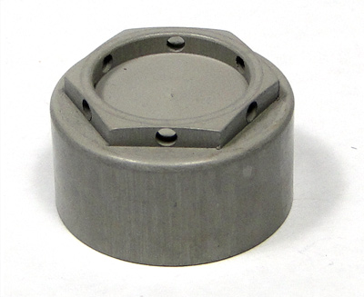

There is a screw-on cover with a gasket you can install.
