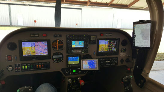

FWIW: I have two 7" Classic Skyviews and a G430W. I only subscribe to the Garmin Database which makes me IFR /G legal. But since I have the WIFI dongle, I use the DYNON database for my moving map and the free FltPlanGo app on an Android Tablet for charts/plates. This set up gives me three "screens" on which to display all the data. With 450+ hours using this set up I find it works extremely well for me. YMMV
