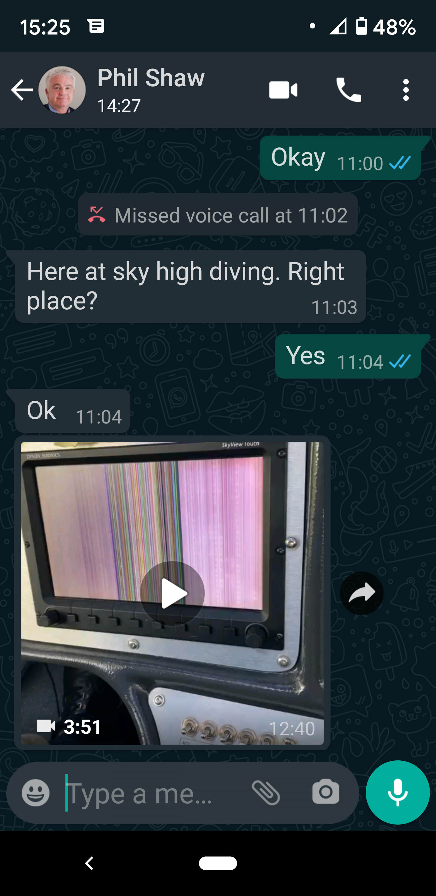

My Skyview will not boot until it has gone through at least 10 attempts. The screen shows vertical lines. It eventually boots sometime on battery power and from the mains. I've tried 1,2,5 reboot keys but to no avail. It's very frustrating and takes about 10-15 mins. I can share a what's app link video. Thanks

Several threads on this issue, which is now known as the rainbow screen of death (RSOD). I just sent my right screen in for repair after it did the same and was getting worse (happening more often). Unfortunately mine was about a year outside the warranty window. It won't get better on its own. Contact support for a return authorization (RMA).

After communicating with Dynon they advised that it was a suspect hardware failure. Dynon were excellent in sorting a service exchange unit. Promptly refunded on receipt of my old unit.
All fired and back to what it should be.
