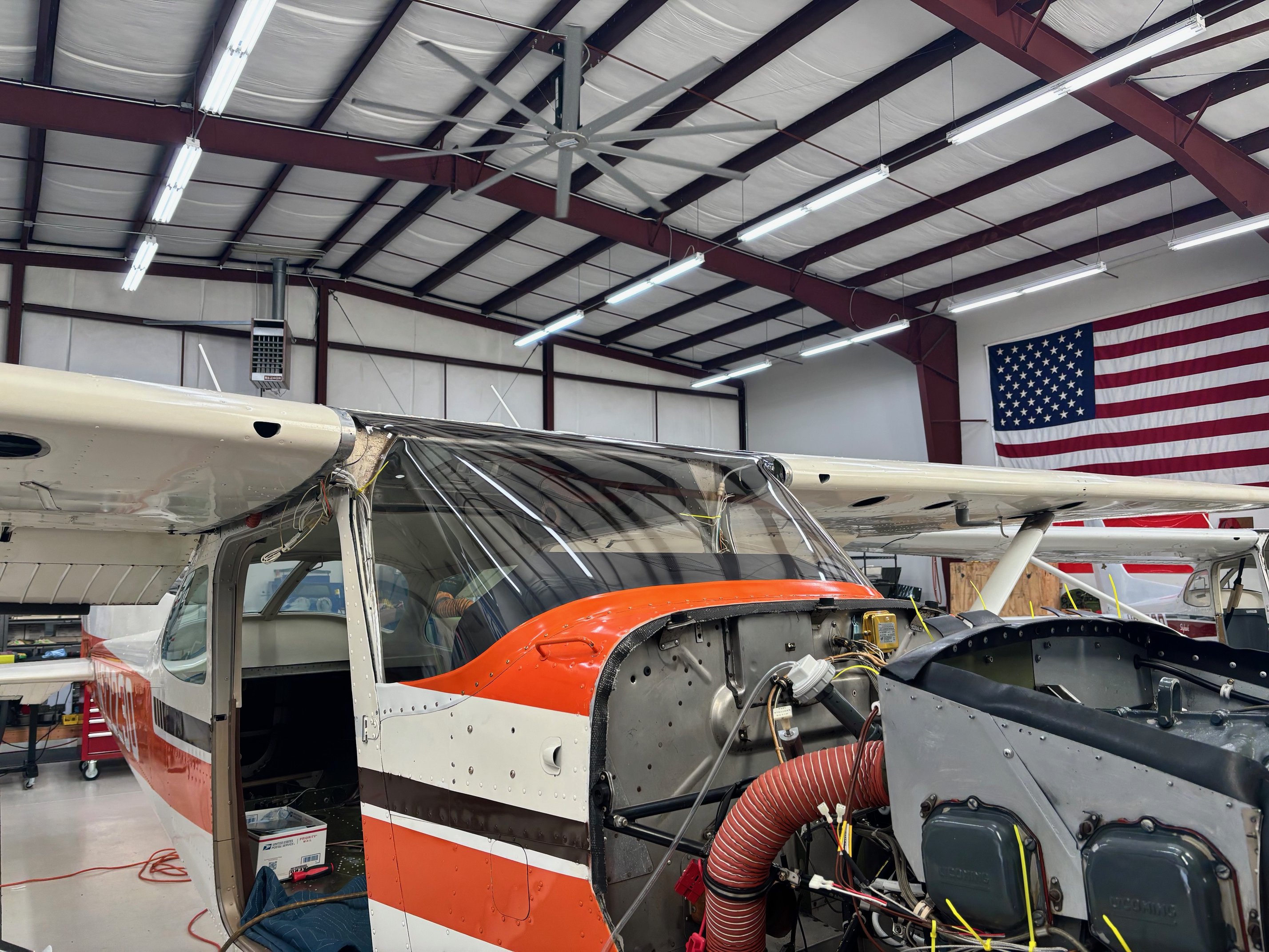

Cool... the new windshield has been installed.
No more peering out of a milky and crazed one when flying into the sun.

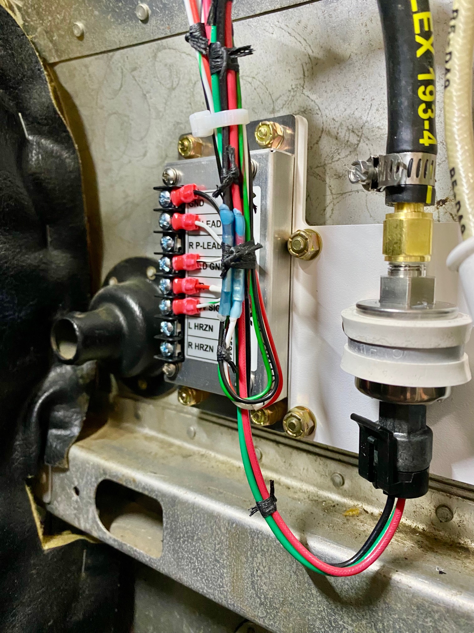

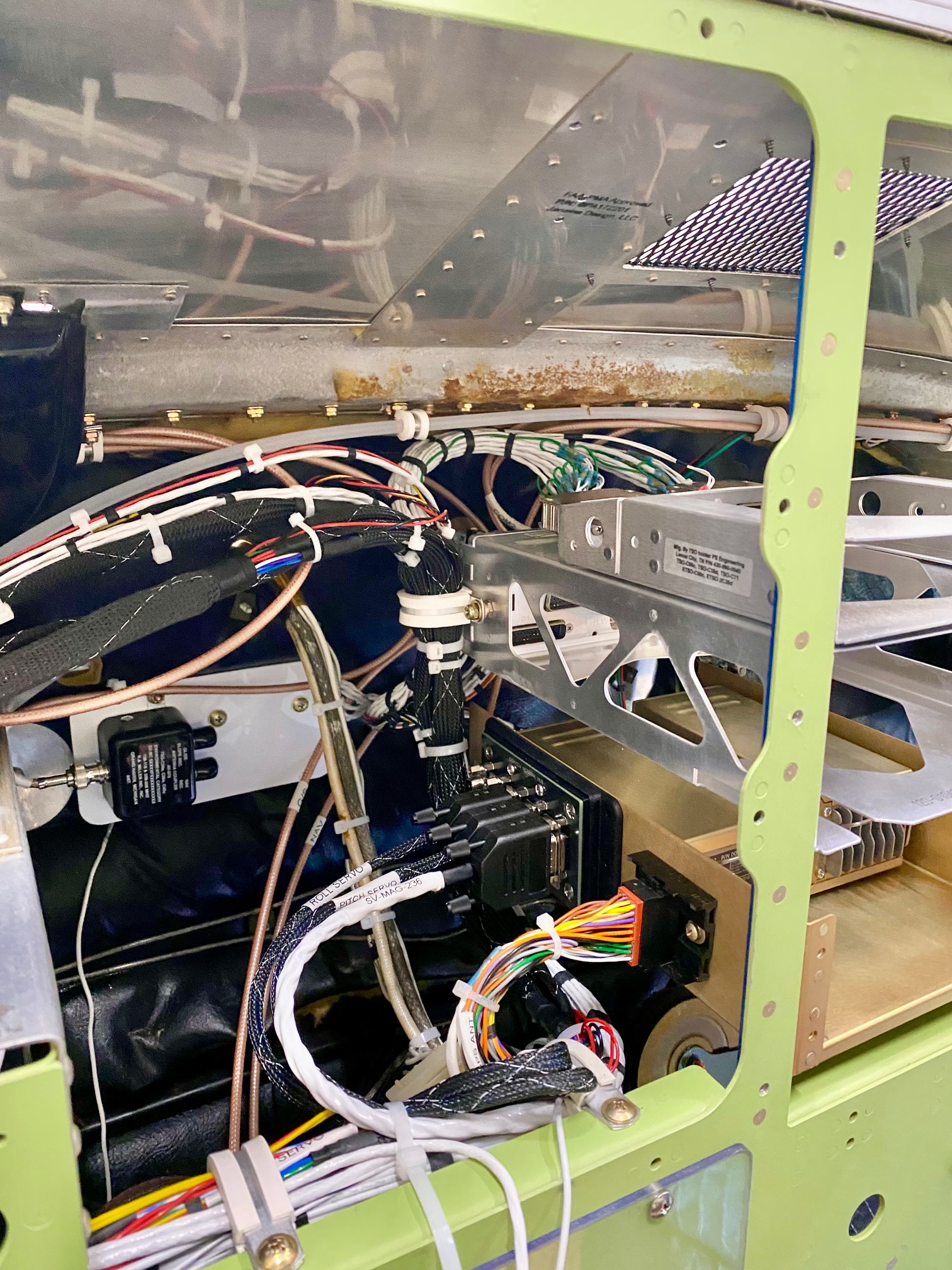

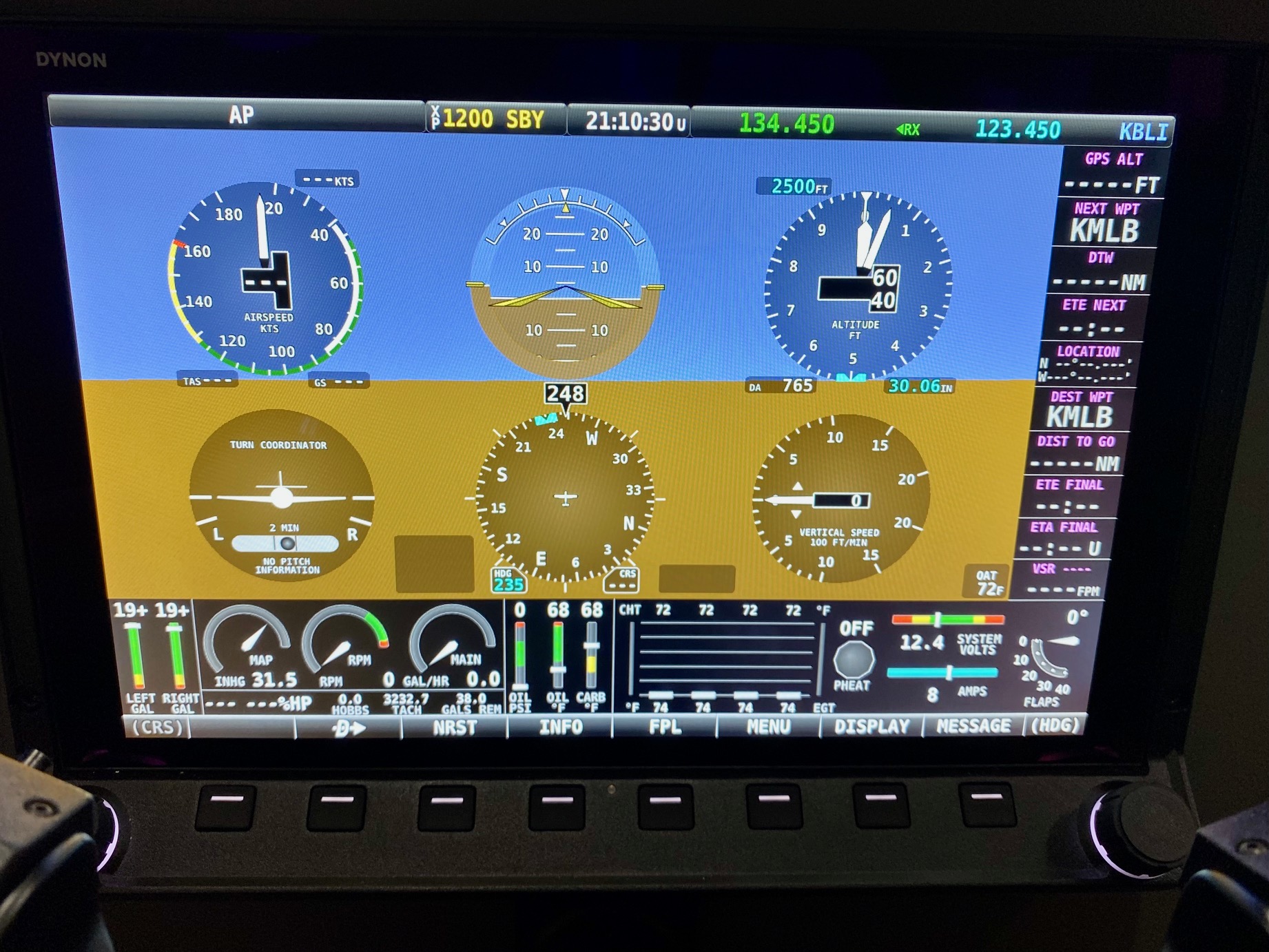

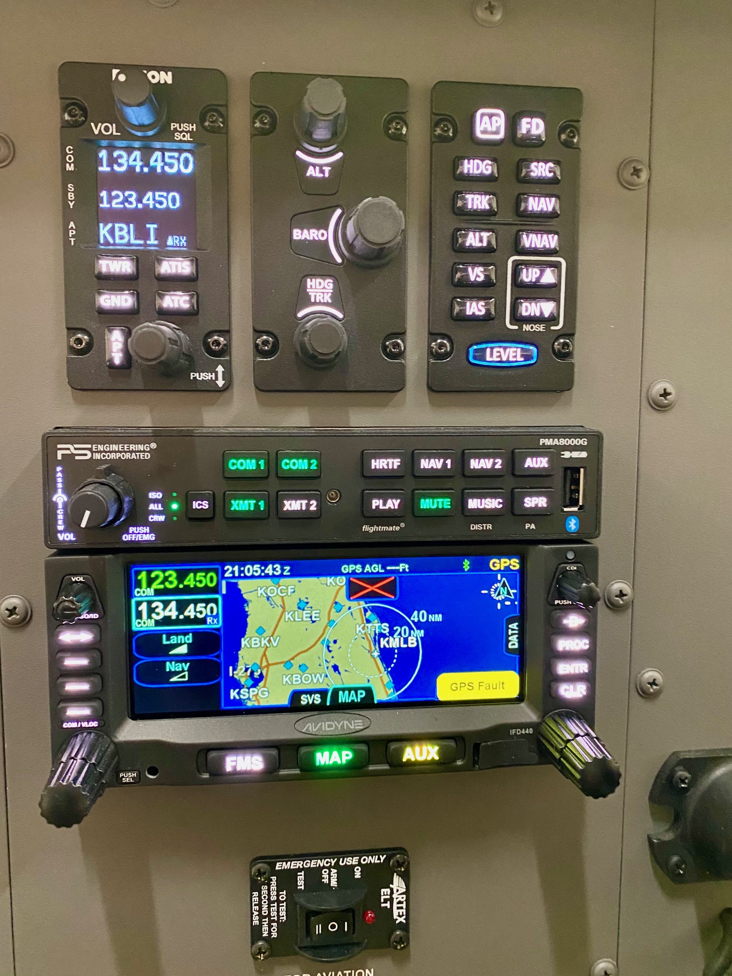

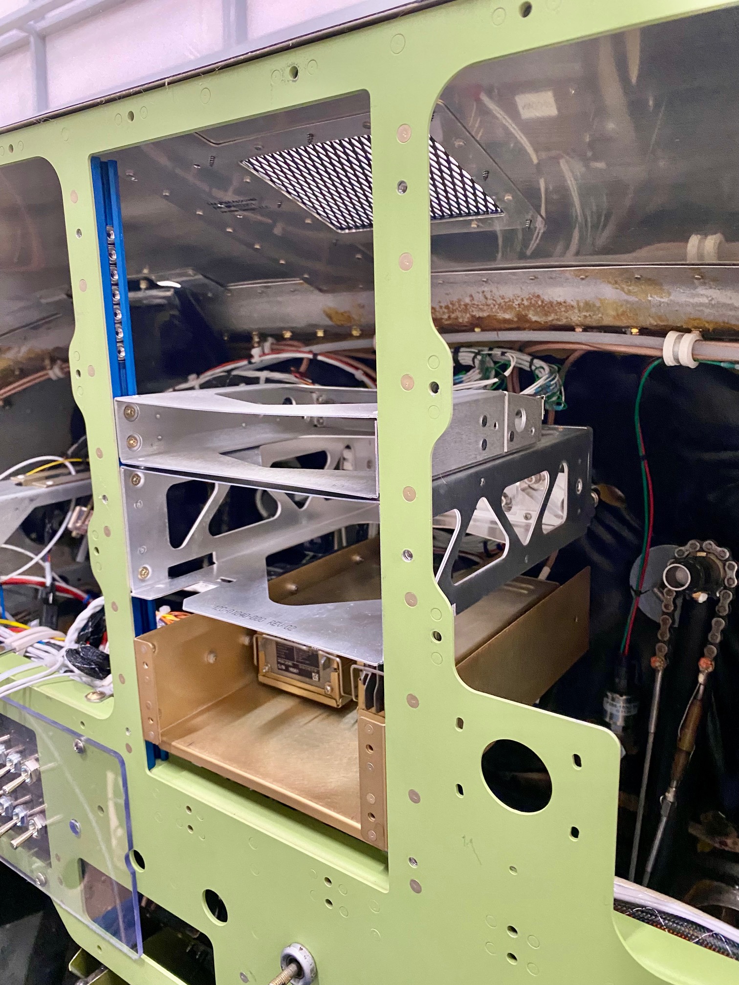

Lots of progress to see, for I have been away for a while...

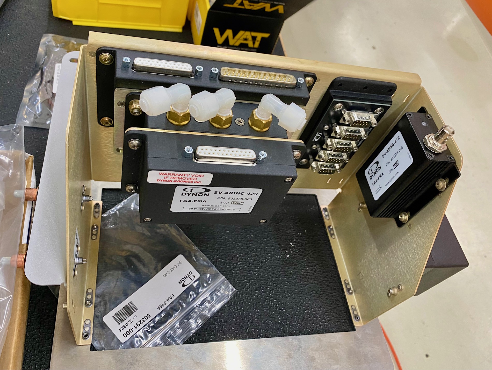

N22230 has a SureFly left magneto installed, so their tachometer signal converter
module was required to be acquired and installed, so that the SkyView could
display the appropriate data during a mag check.
Power should be applied to the entire panel sometime very soon!

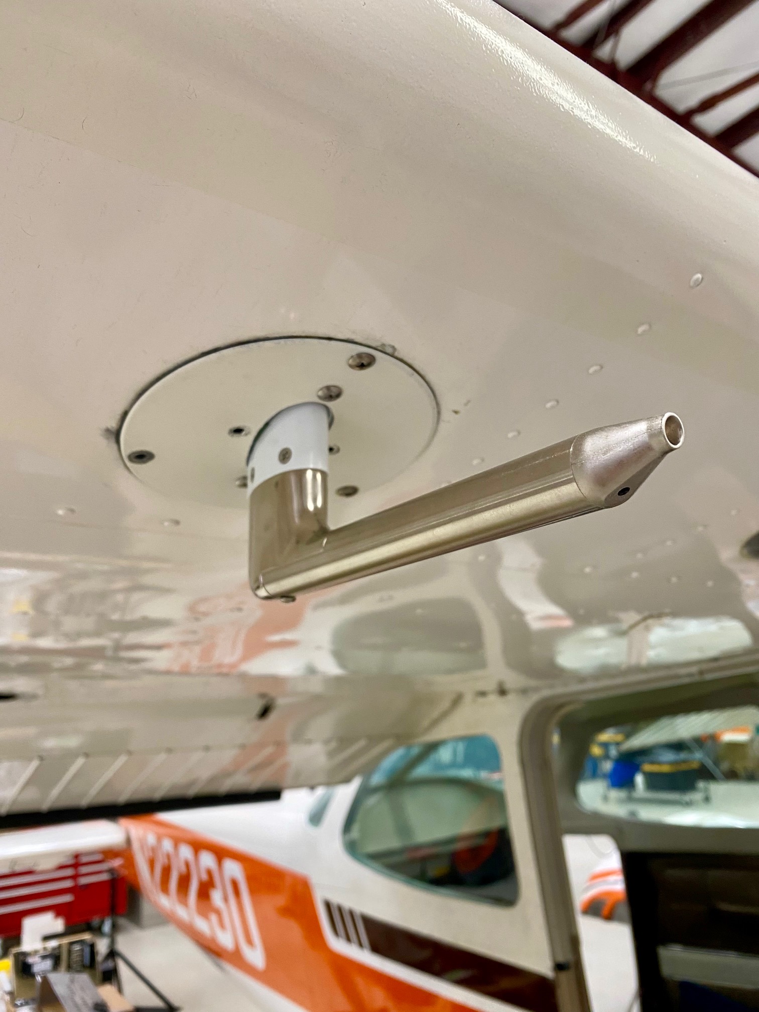

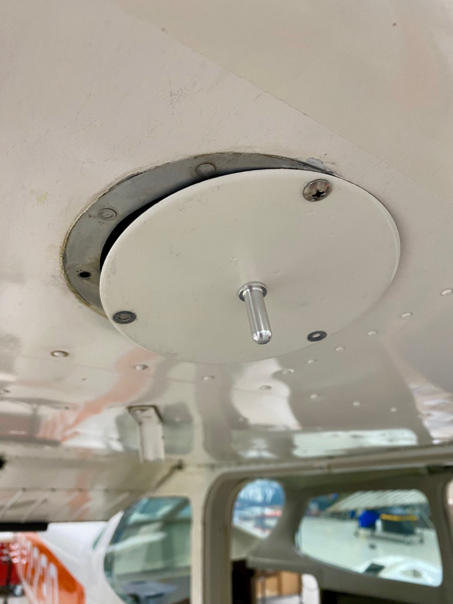

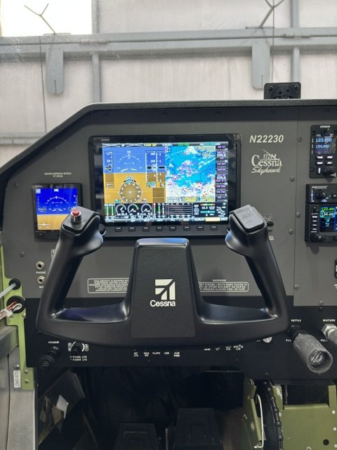

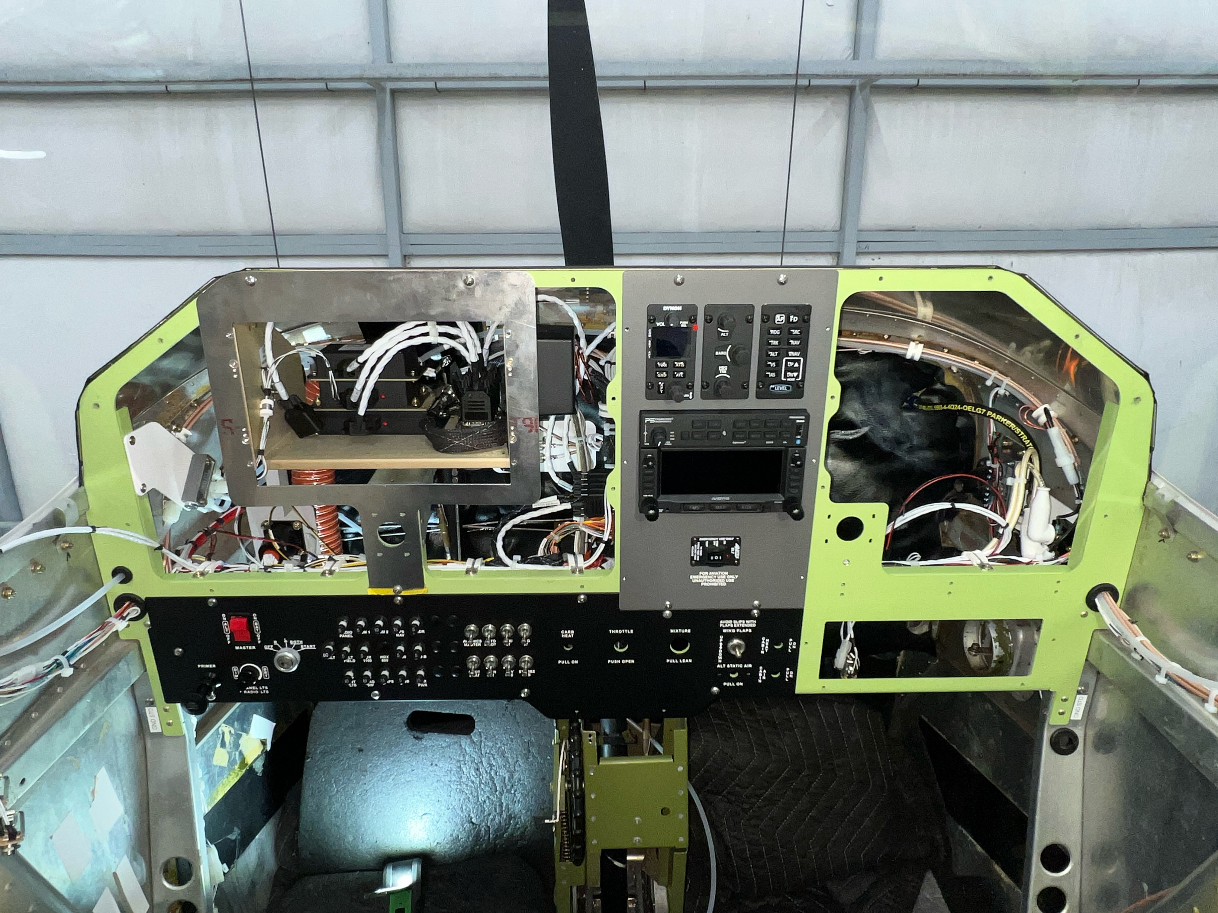

Feb 19, 2025
43
Lynden, WA

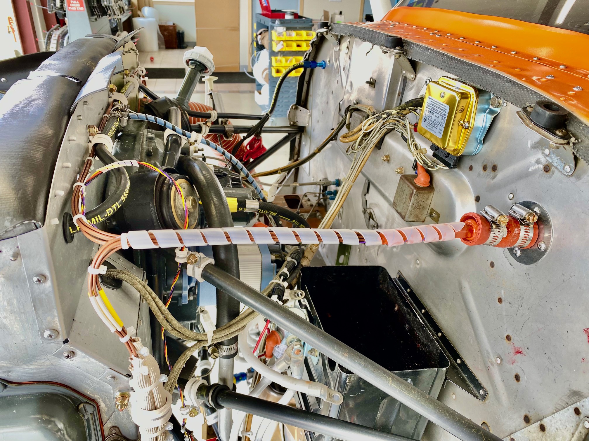

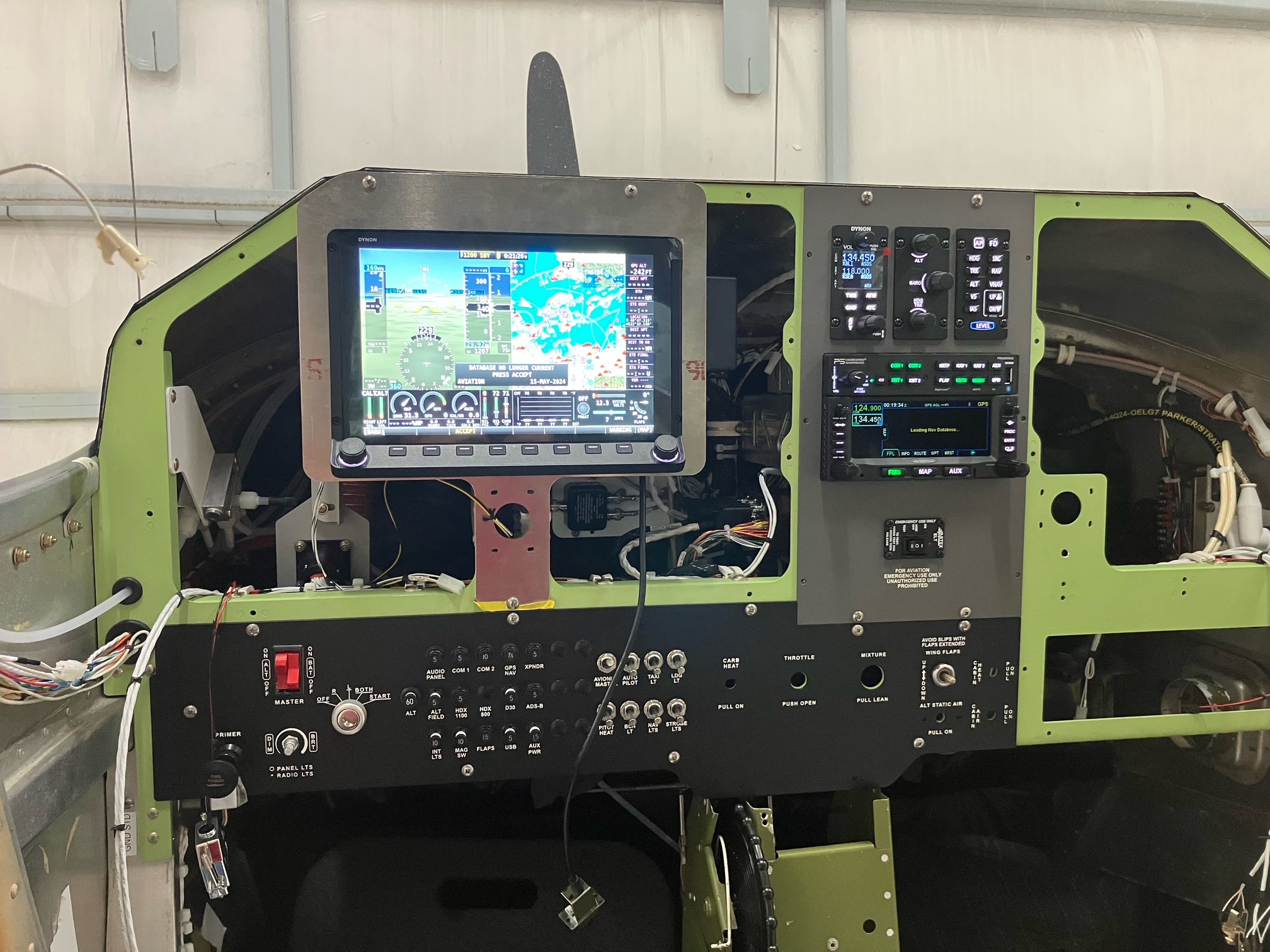

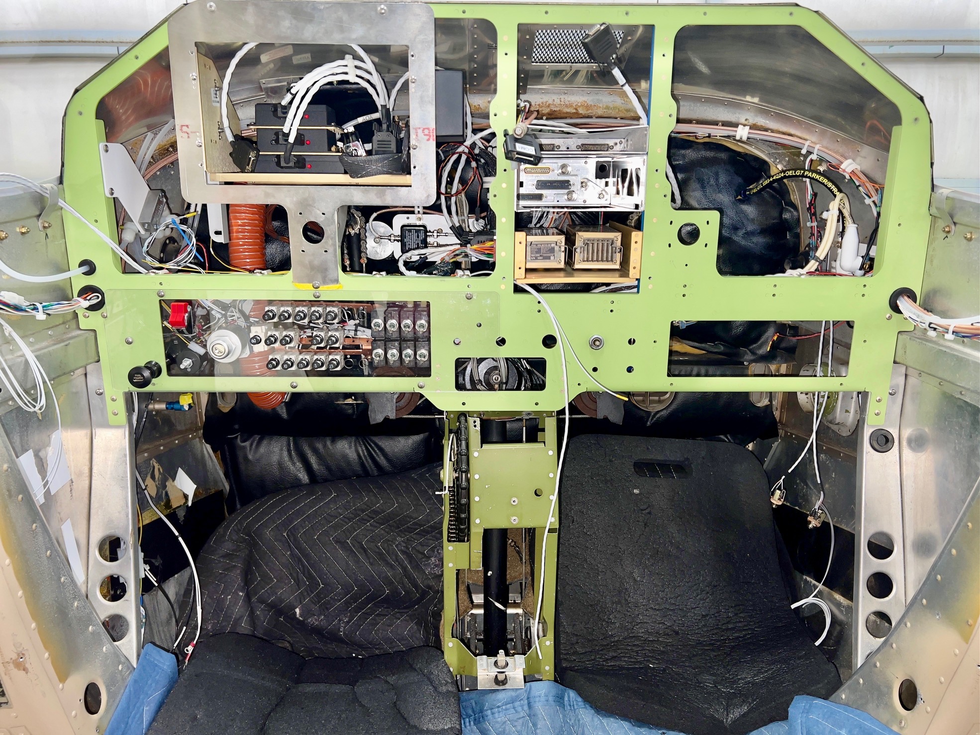

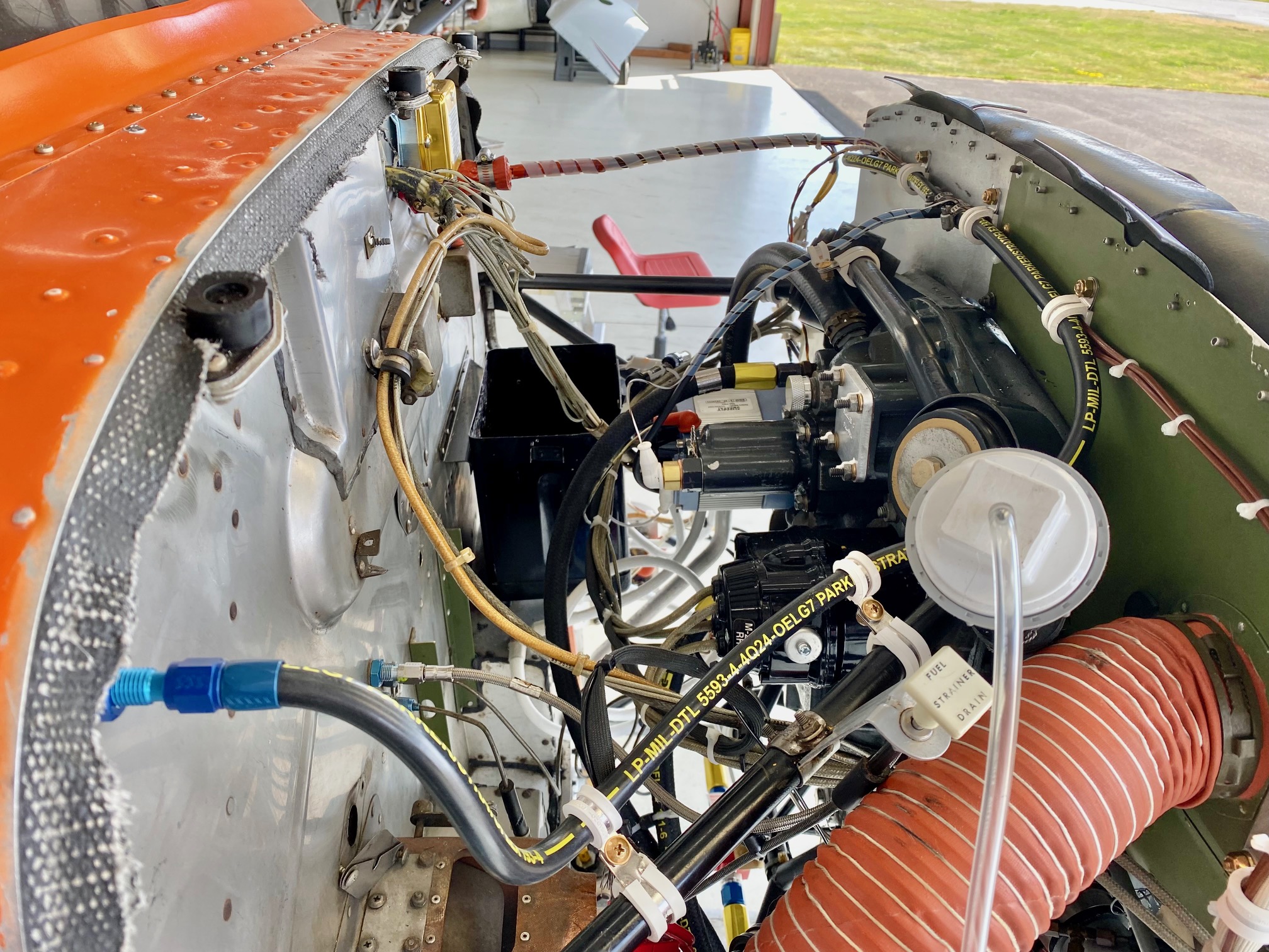

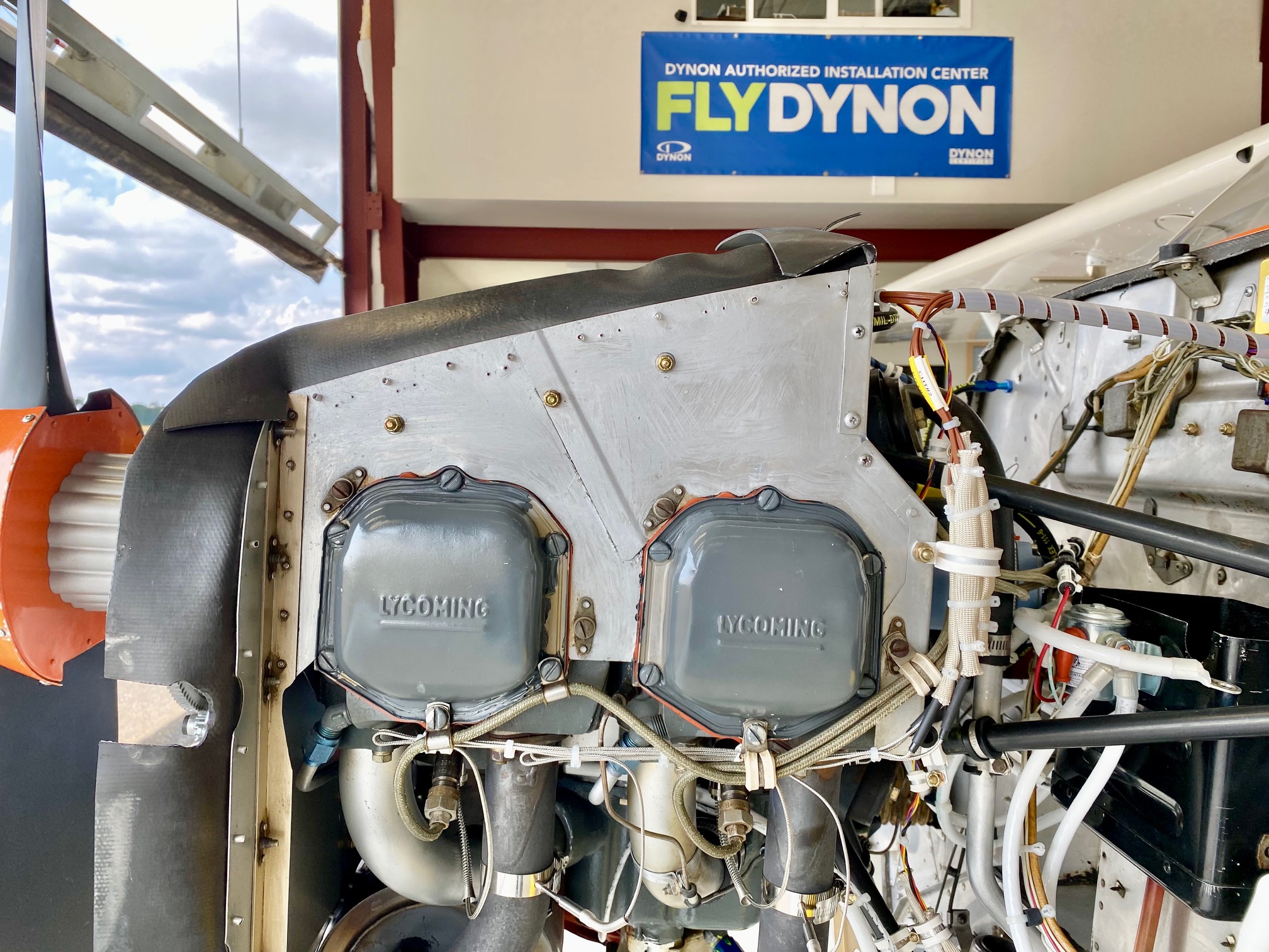

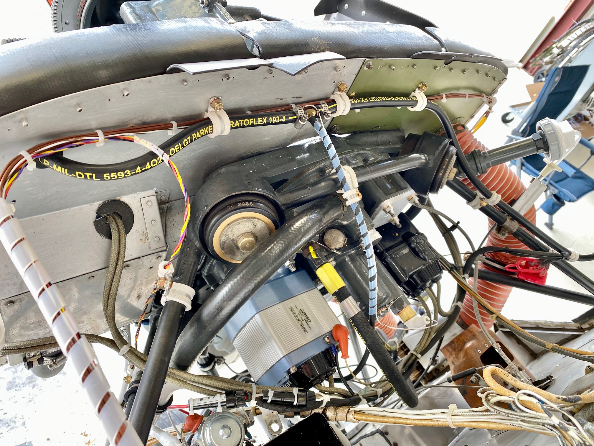

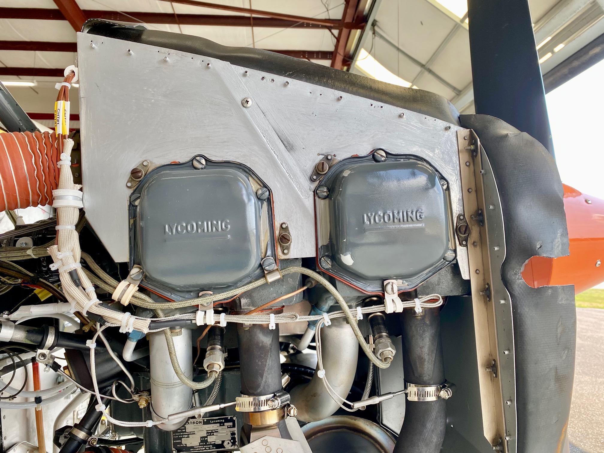

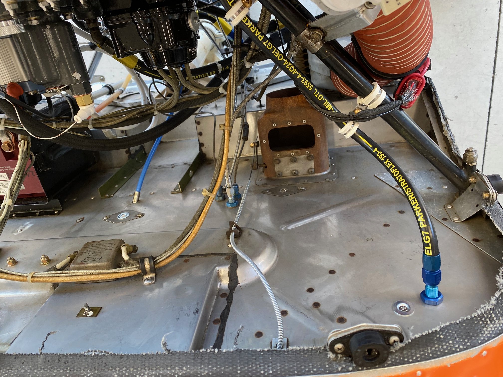

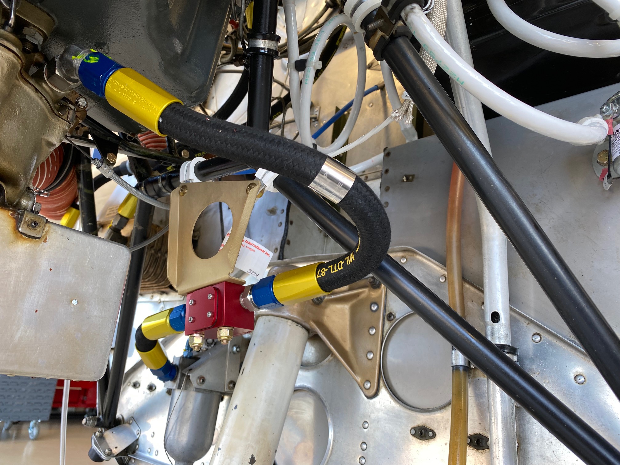

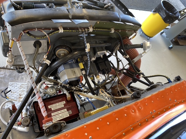

Firewall forward has been completed.
The lower panel wiring has been completed.

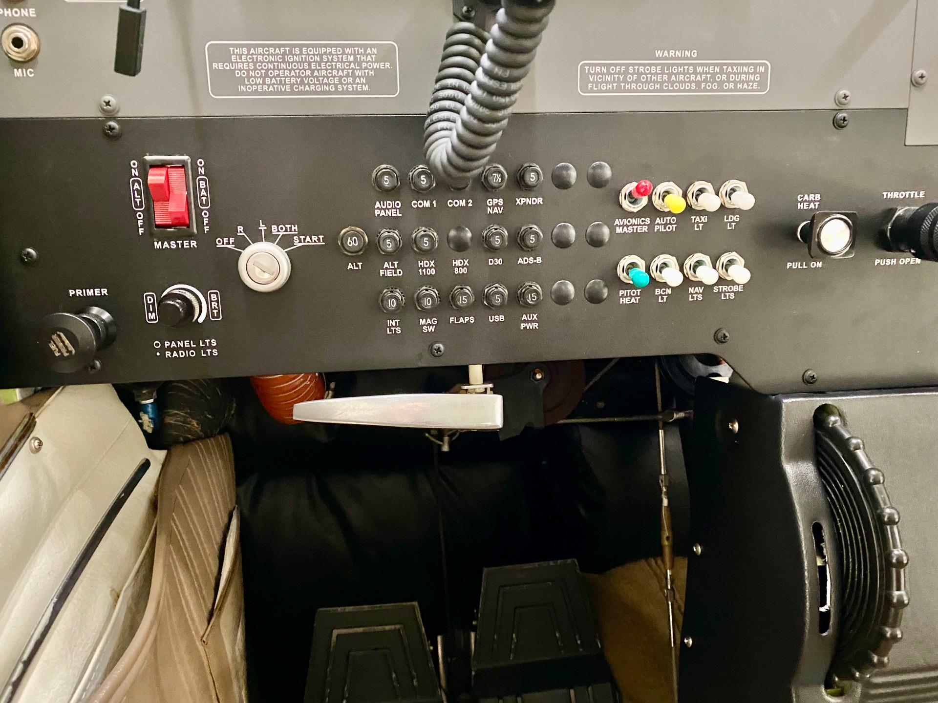

benapilot
Dec 19, 2017
23
This whole thread is super helpful as I‘m designing my own HDX installation…
I see a 5A breaker for “USB” and a 15A for “AUX POWER.” I’m assuming the 15A is for charging ports, but what is the USB breaker powering?
Feb 19, 2025
43
Lynden, WA
I'm glad that you are enjoying the thread!
The 5 amp circuit breaker protects the 2-port USB component and the 15 amp circuit breaker is for a cigarette lighter outlet.

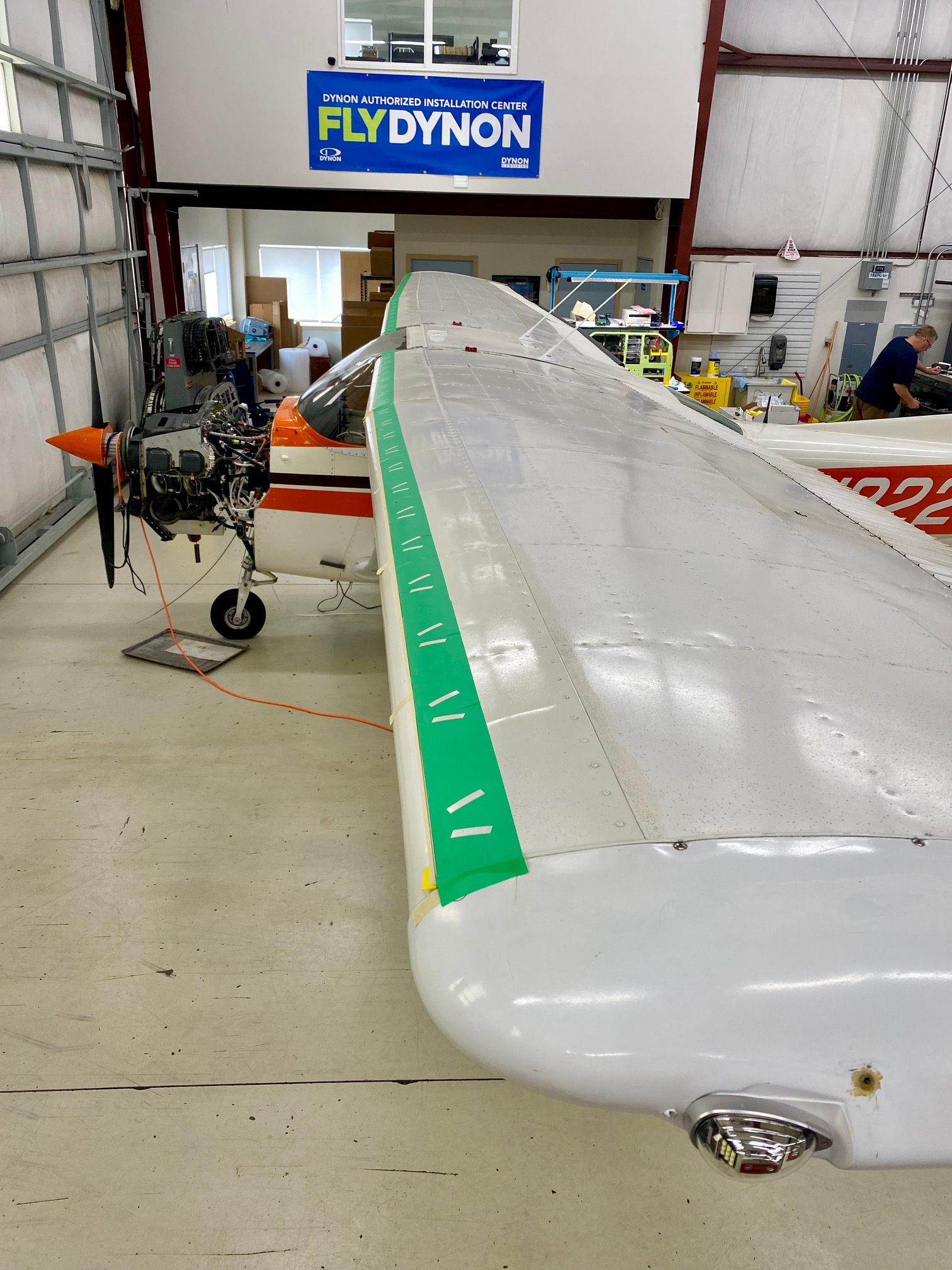

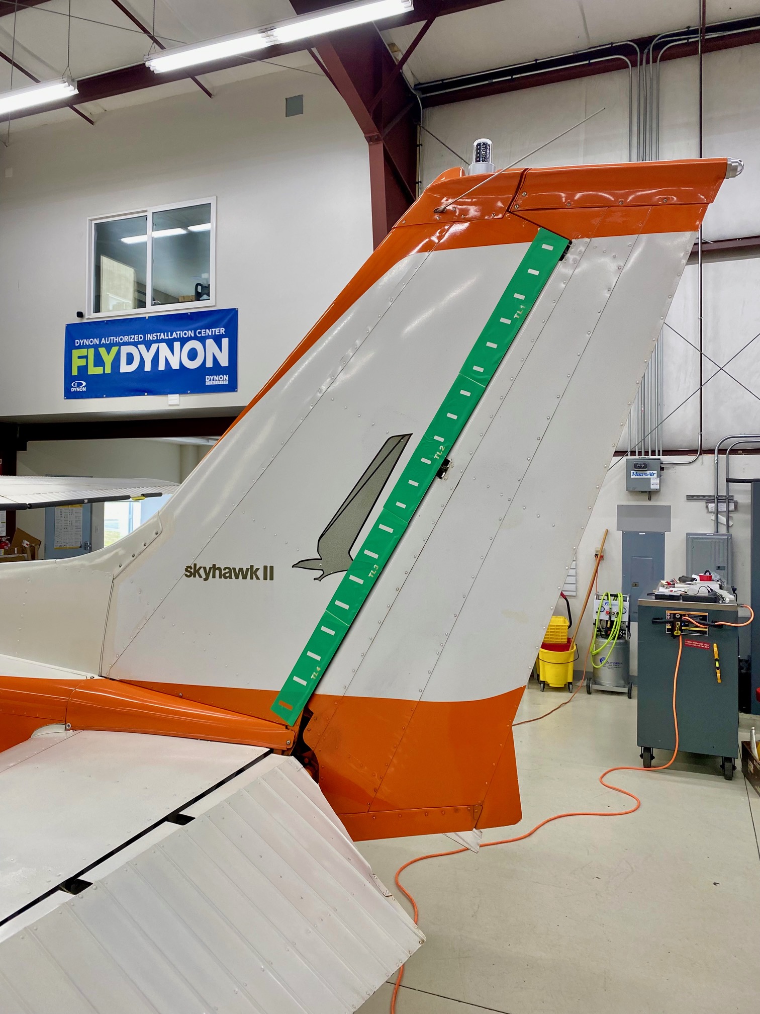

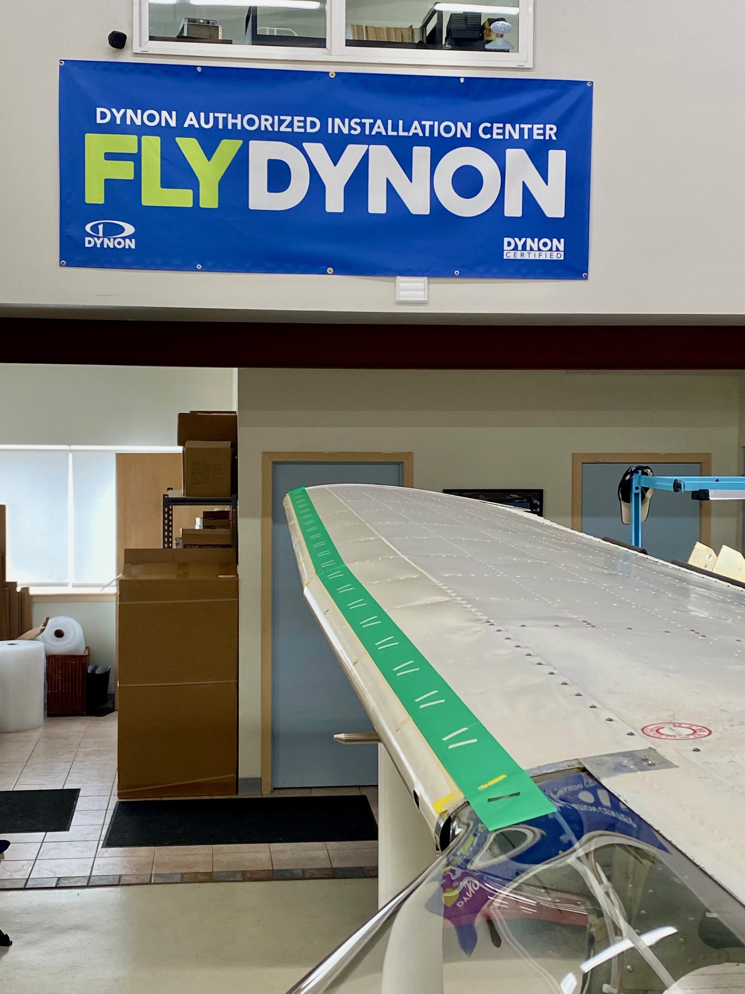

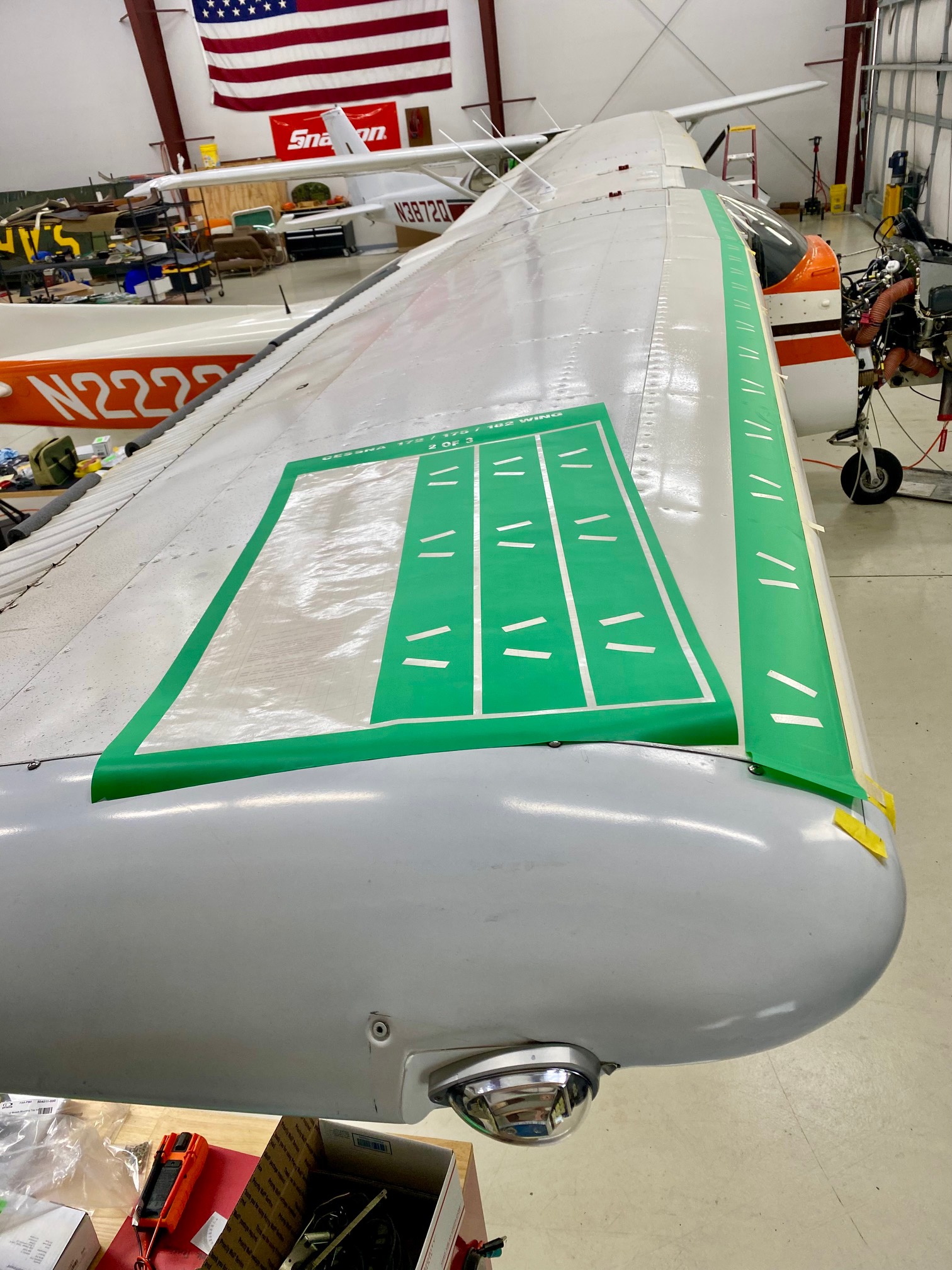

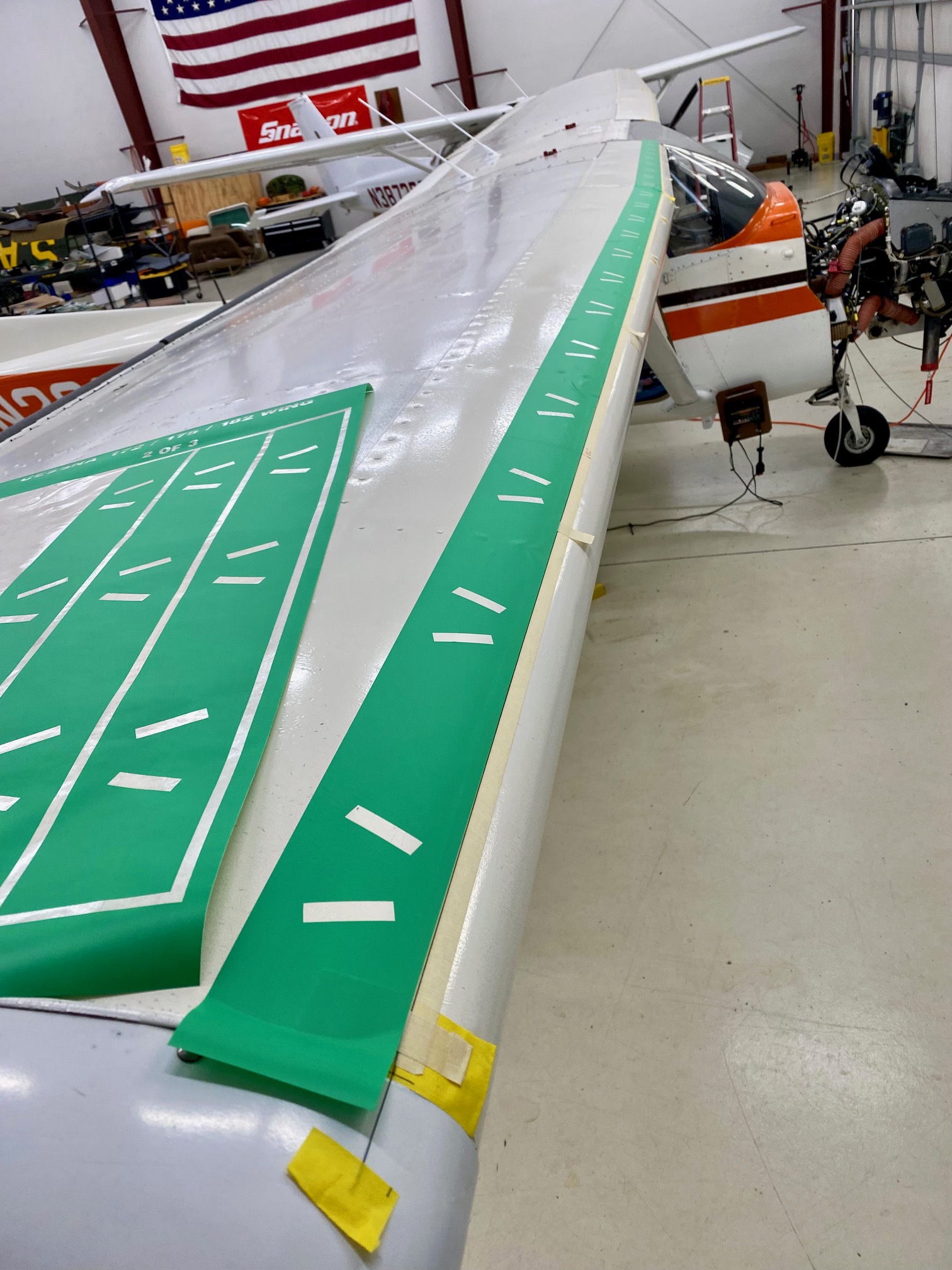

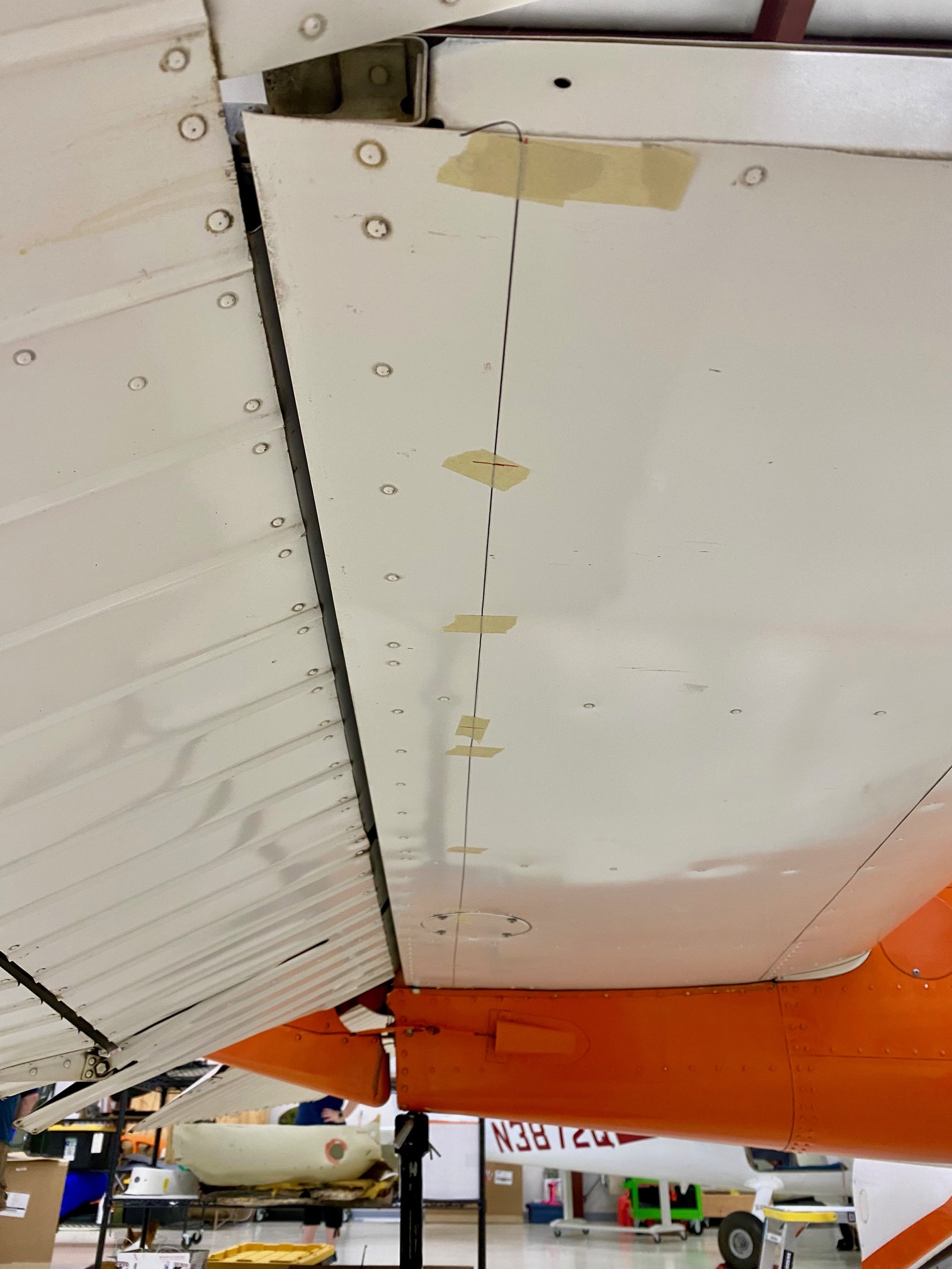

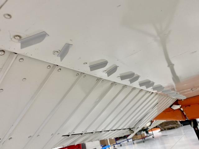

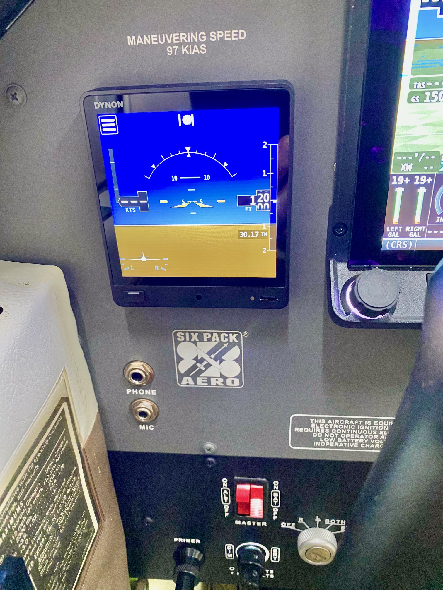

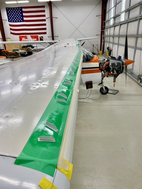

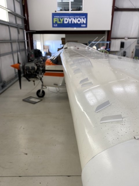

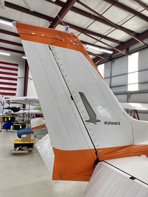

Six Pack Aero is installing the VGs, too!

Feb 19, 2025
43
Lynden, WA
More progress to share. Almost done...

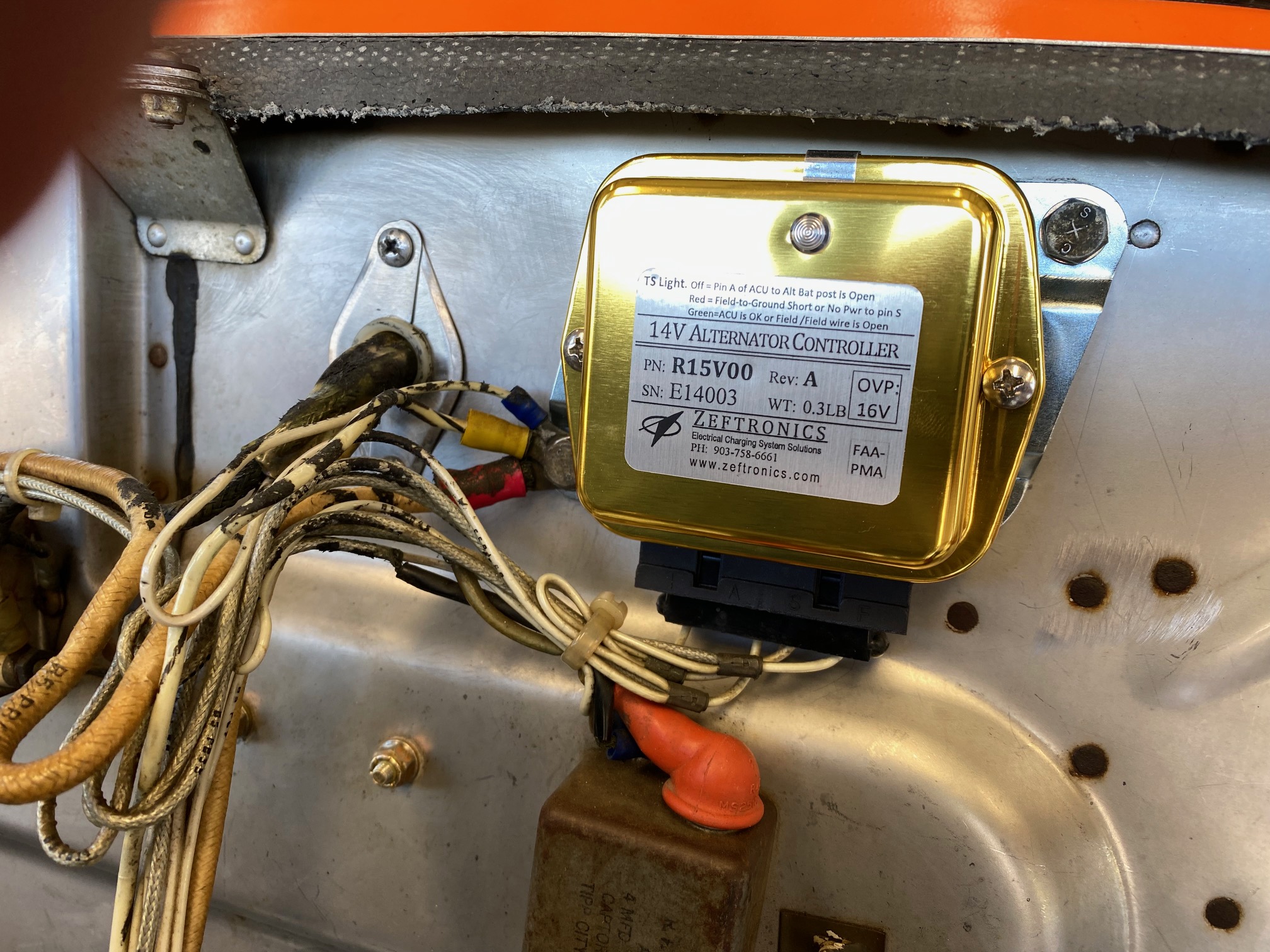

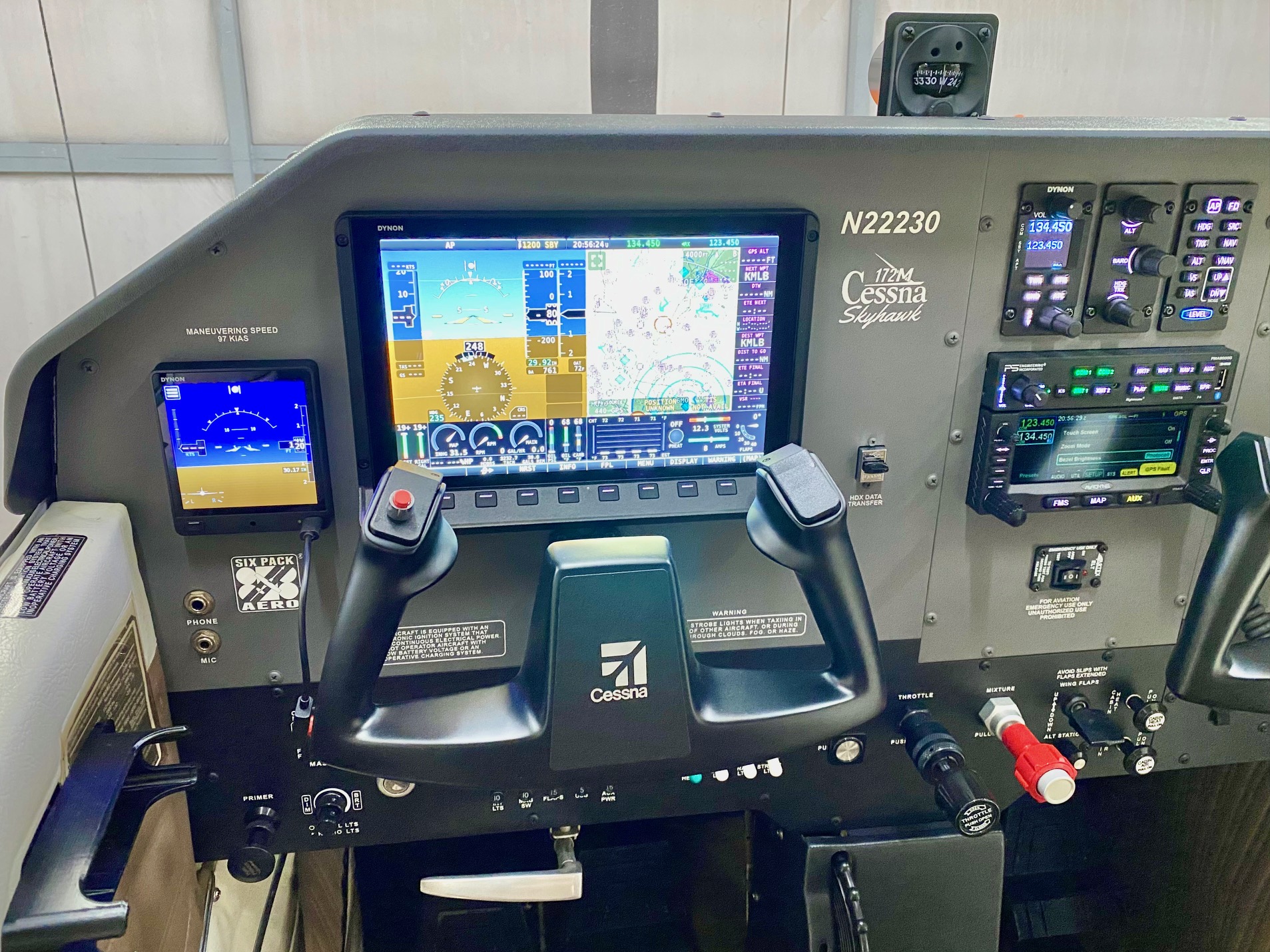

Feb 19, 2025
43
Lynden, WA

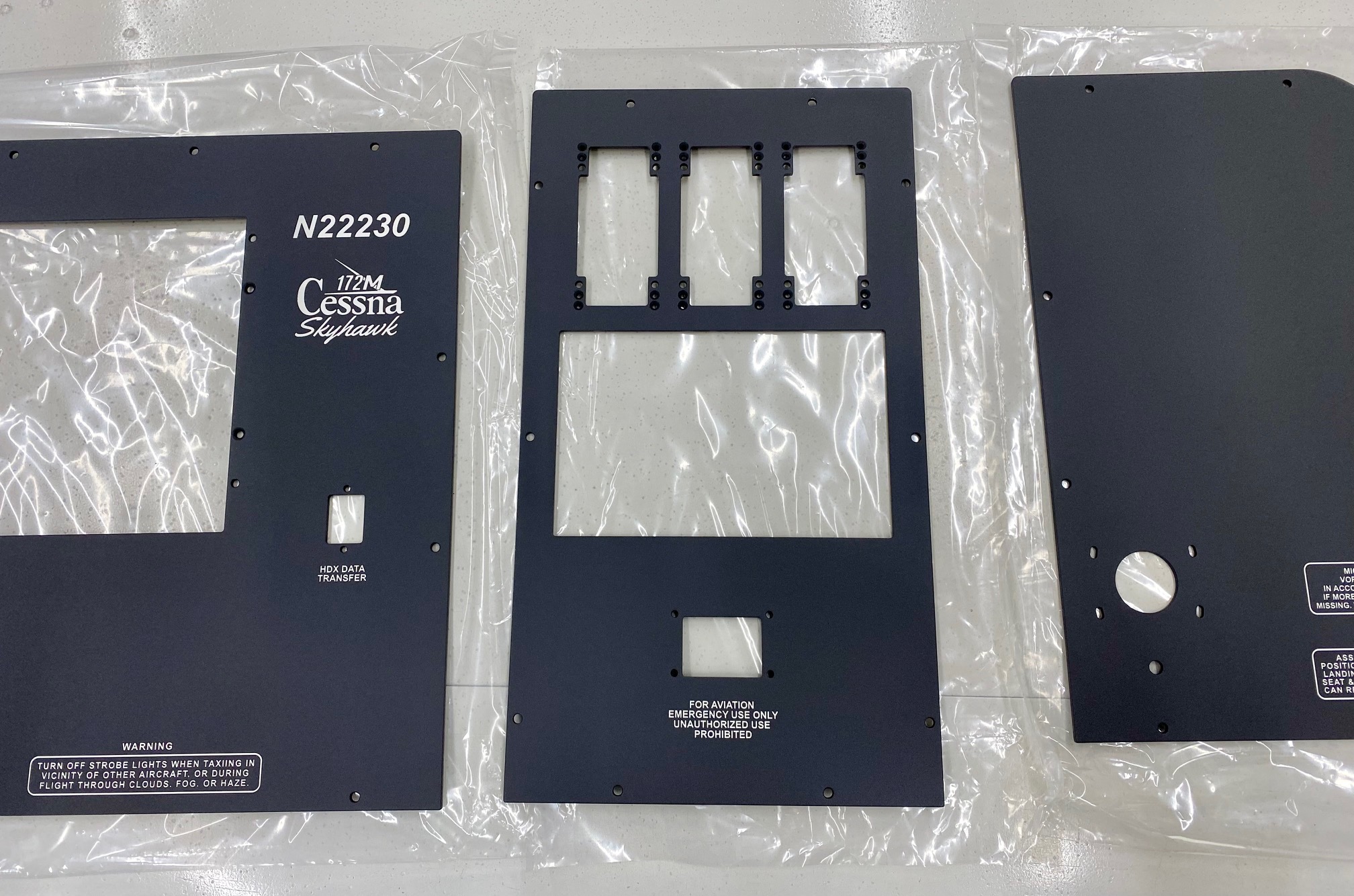

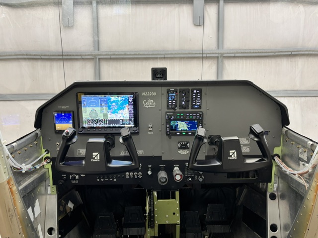

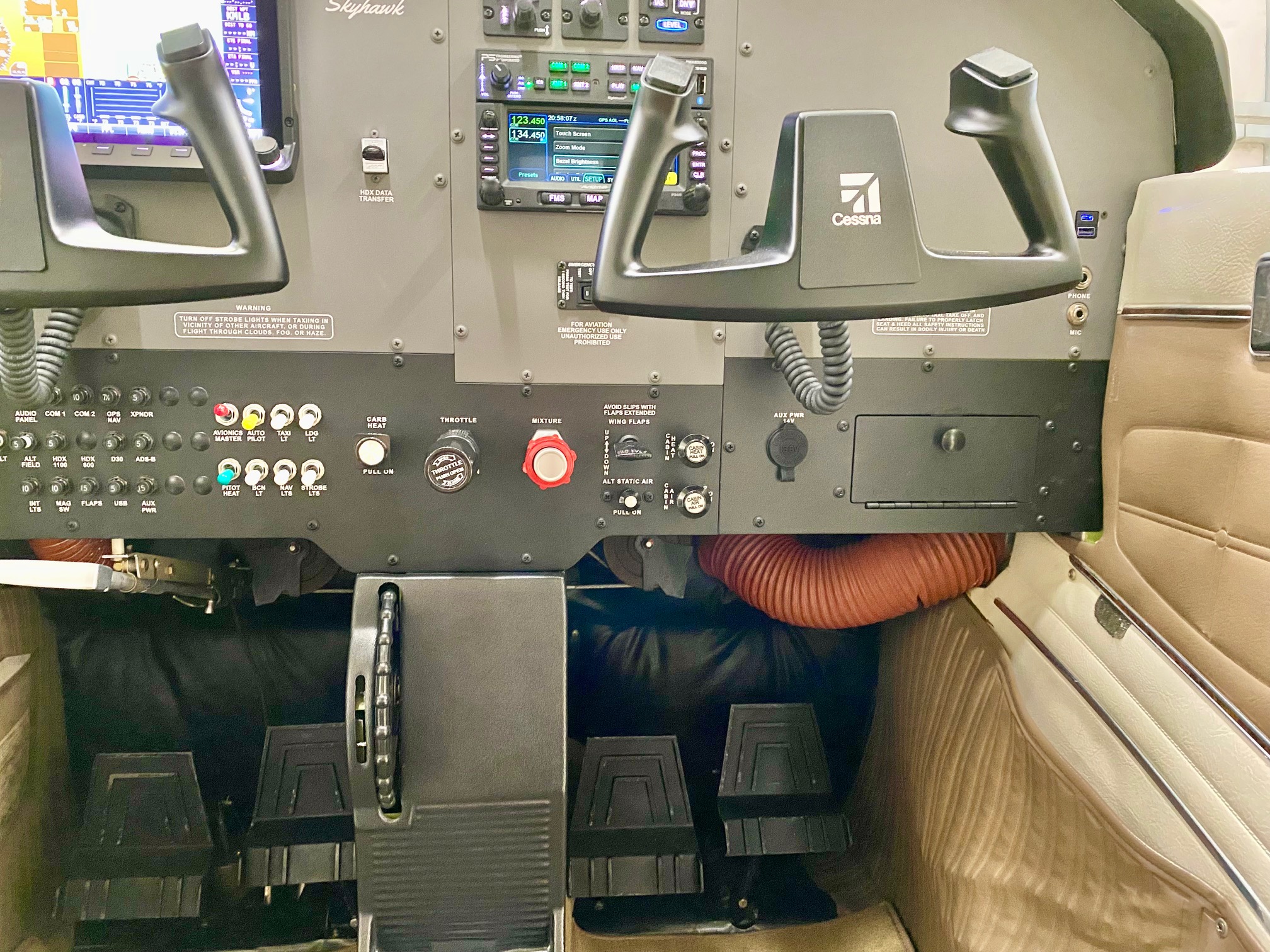

The project has been completed!
Next up: Weigh the 172 for the new weight-and-balance data and perform some Dynon software calibrations.
WIP... but almost done!
