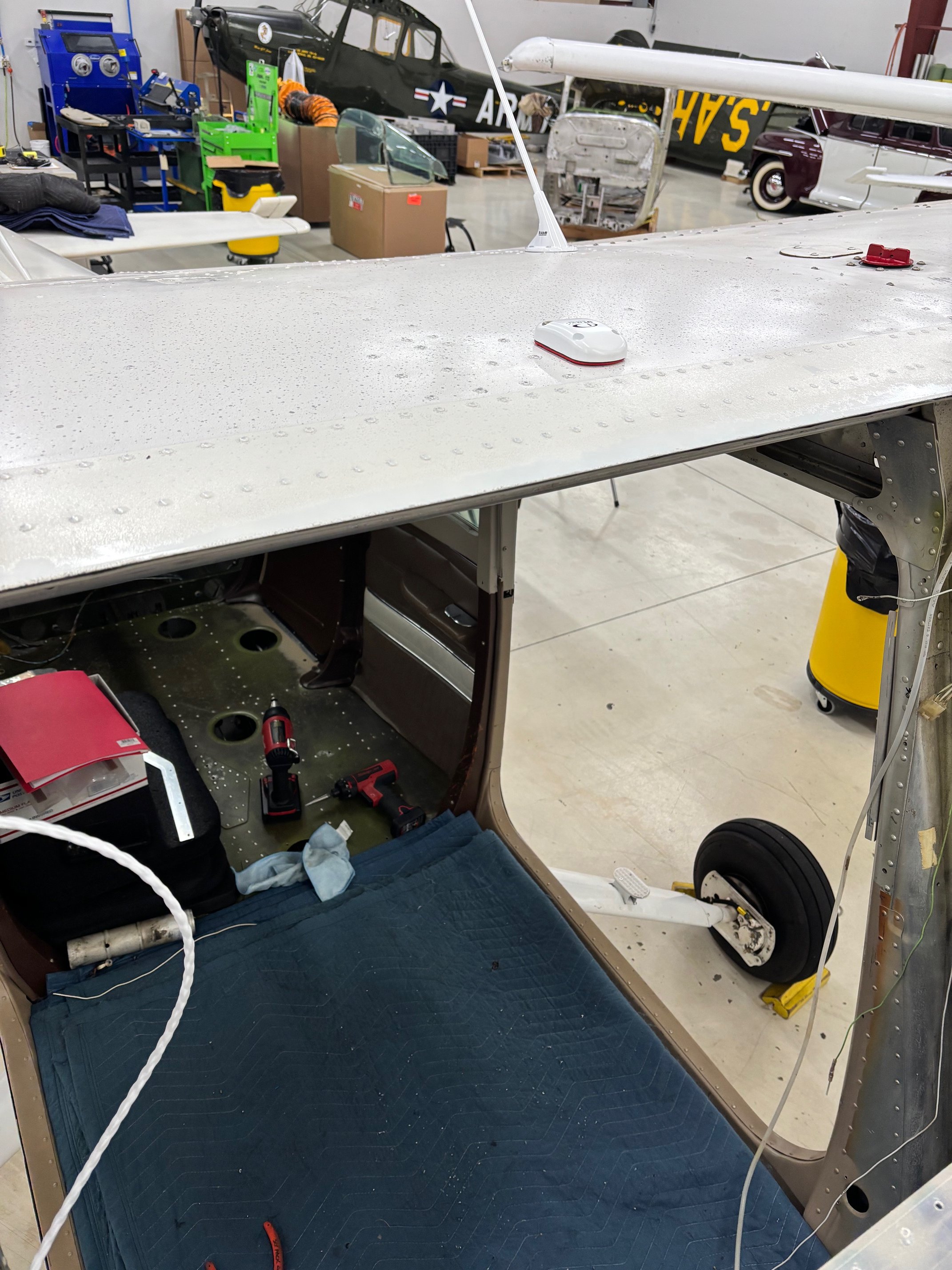

More progress...
The magnetometer and Dynon GPS antenna have been mounted.
Wire harnessing in the wings are installed and secured, as well as wing tip strobe and nav light wiring.
Wiring for the pitch servo has been routed and installed under the floor.
The engine management system wiring has been routed into the engine bay and connections are in progress.
Stay tuned for more action!

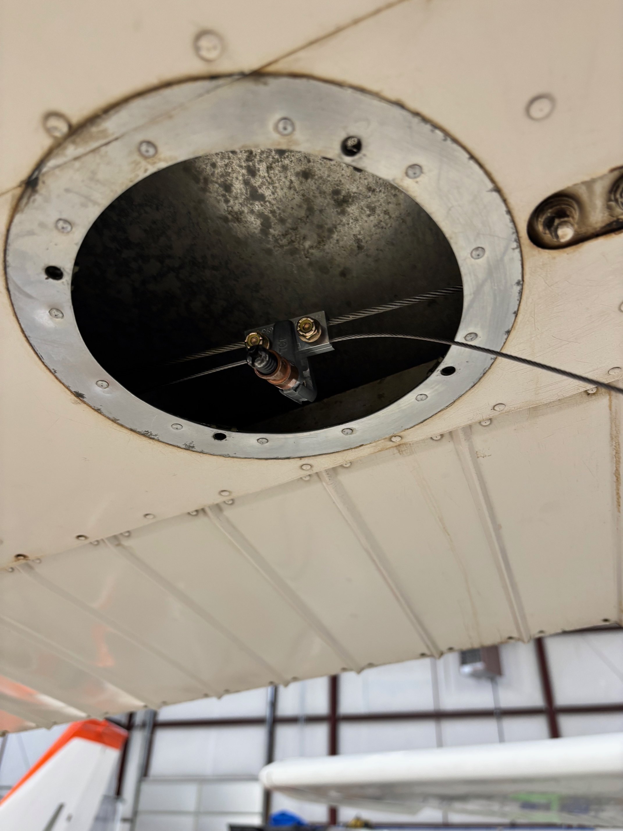

I just had to pay a visit to Six Pack Aero this afternoon to visit N22230...
The 172 Roll Servo Guard Service Bulletin has been complied with.
The pitch servo assembly will soon be attached to the belly of the airframe with AN hardware.
I forgot to snap a picture of all of the new wiring harnessing that have been routed to the instrument panel area.
Maybe, I will visit the shop in a couple of days!
1,183
Make sure the roll servo bridle cable clamps are torqued correctly - the torque specs have been changed from the original documentation. I had "another" shop do the install on mine, and they hosed it up.
Feb 19, 2025
43
Lynden, WA
Thank you for the heads up about this issue, for that is appreciated. I'll chat with the shop about the torque value that is applied to those clamps.

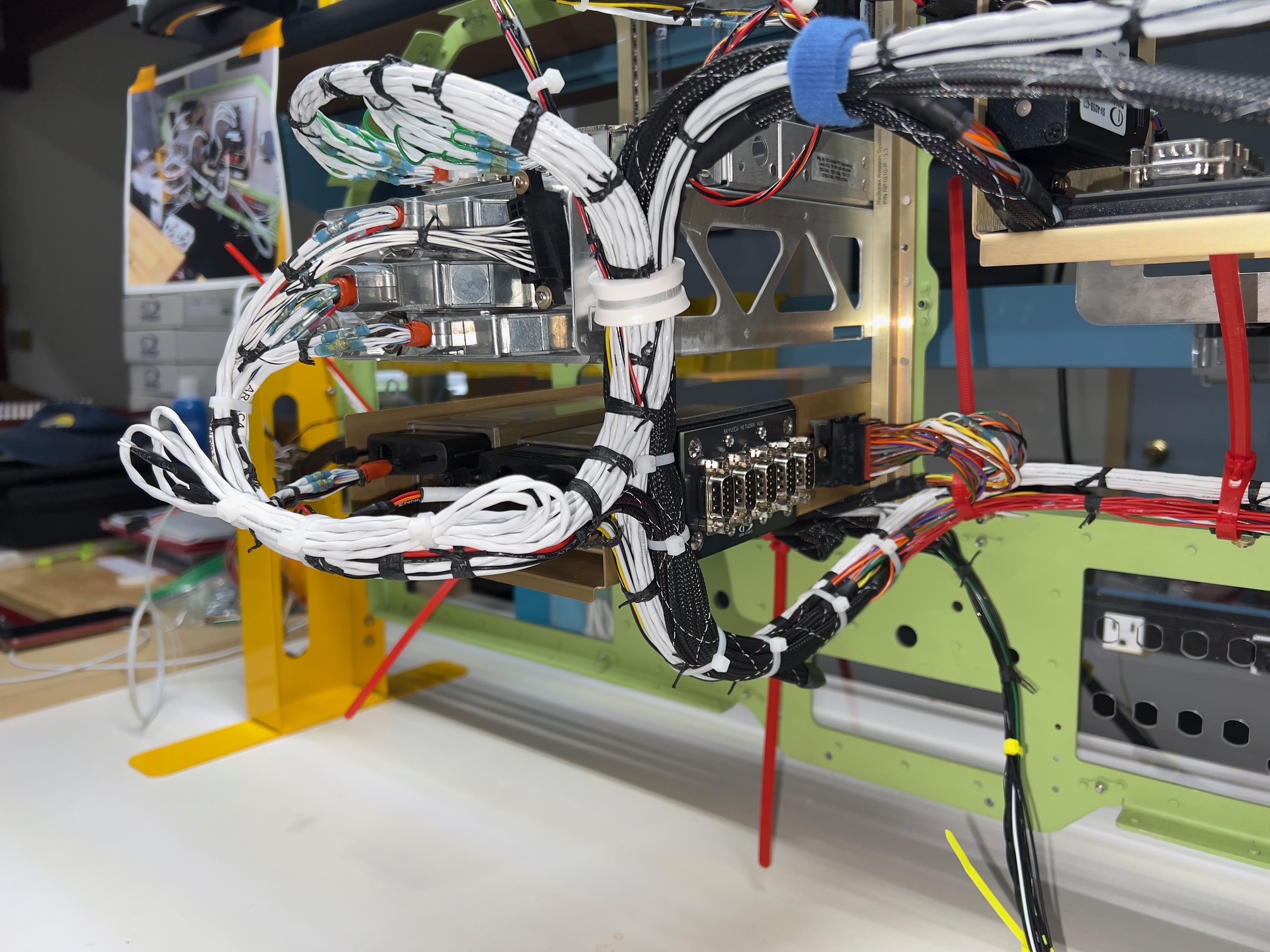

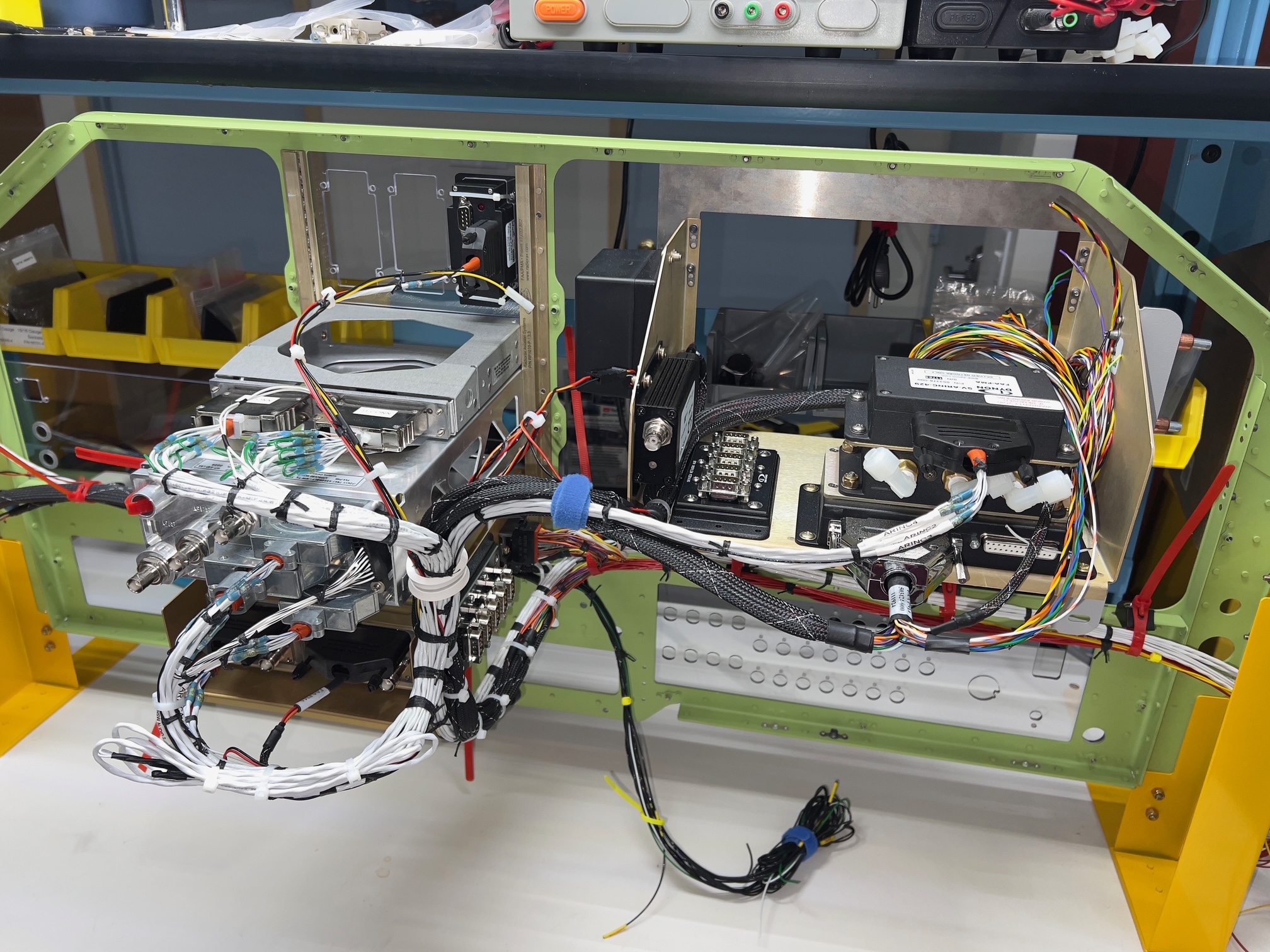

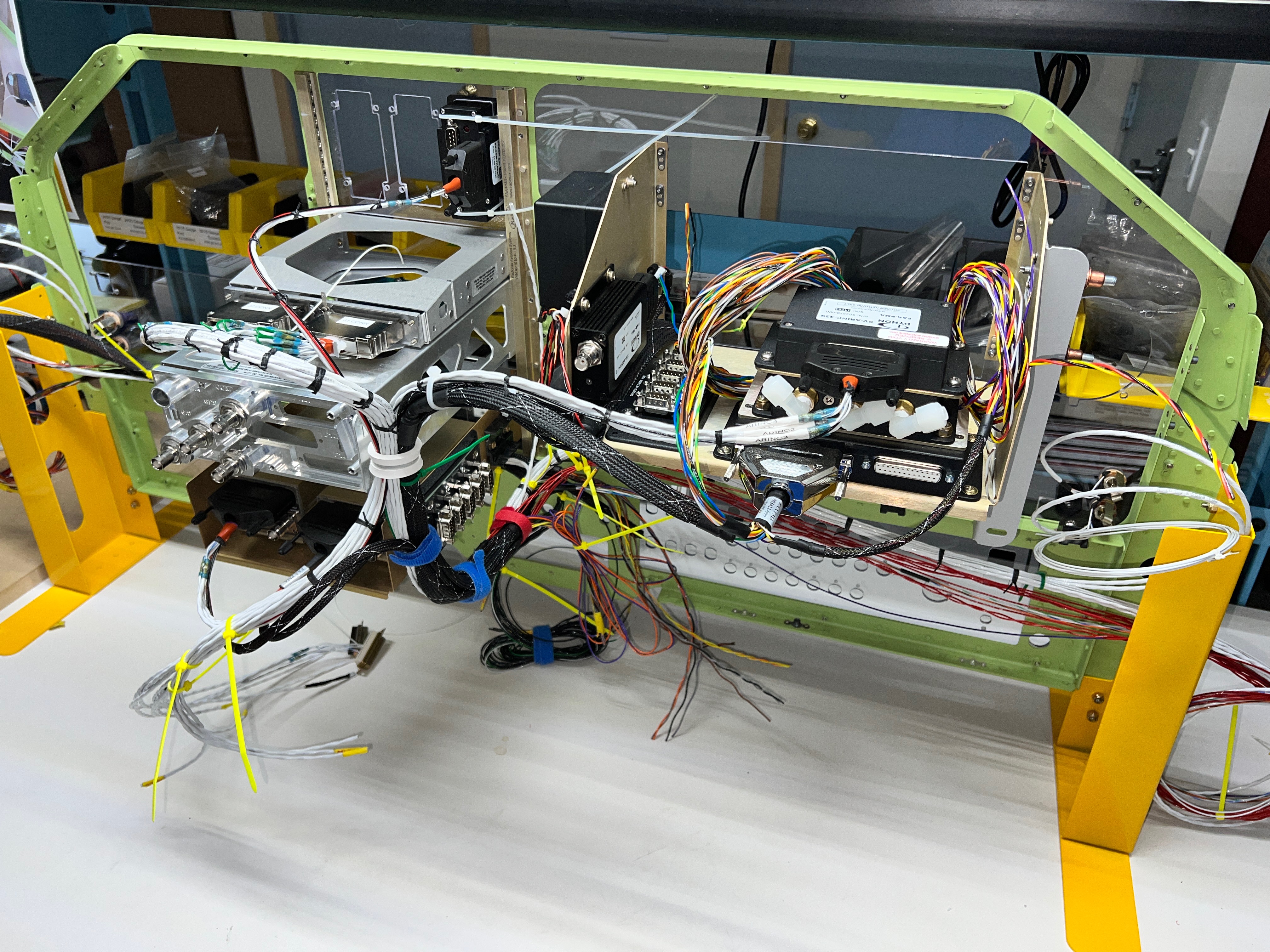

Great progress to report on interfacing the Dynon SkyView HDX, the Avidyne,
IFD440, the PS Engineering PMA8000G, and one Dynon control panel.

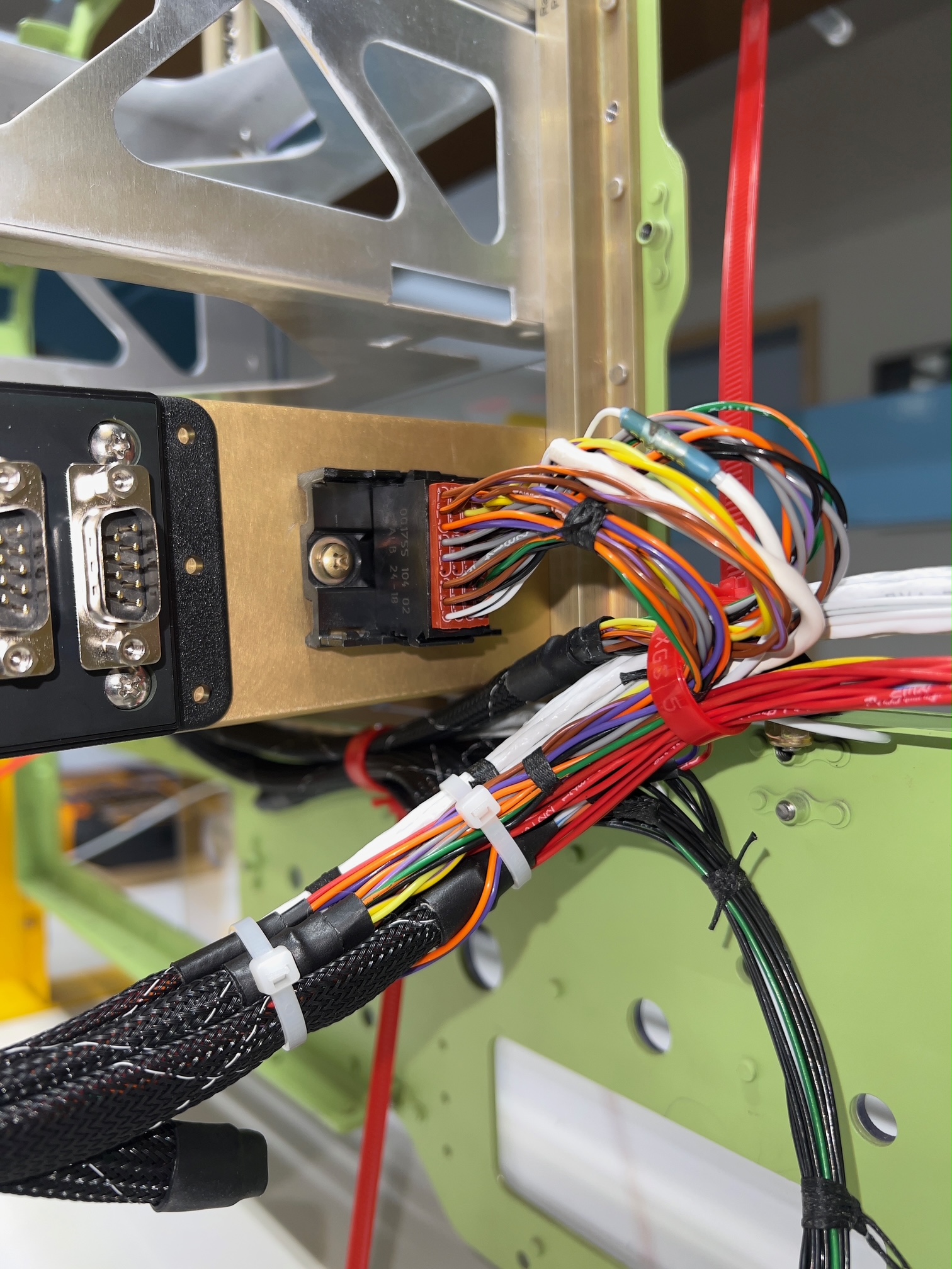

One the mounting tray, I see the EMS, ADAHRS, ARINC modules stacked. On the left I’m assuming the ADSB IN module?
Great idea with a network hub on the side of the radio tray.
What’s the connector in front of of it (pic 3)?
I can’t quite make out the brand of the avionics mounting rails…. Radiorax? I’m considering using their system when I do my panel.
Thanks again for posting!

Full disclosure: I lack the training, skill sets, and experience to answer your
avionics/electrical questions.
It's probably best that you contacted Six Pack Aero, and had them clarify
your questions.
I'm sure that they would be glad to help you in any way they could. They're
very friendly!
I believe that is the ADS-B In module on the left, but I'm not 100 percent certain.
Here's the link for that component on Dynon's website. Hope this helps.
The same circumstances for the connector that you reference. I am not sure of
what is connected to it. Six Pack Aero would have the answer to that question.
I'm sure if you reached out to them, they would be happy to answer your questions.
Here's their contact link.
1,856
On the left of the Dynon tray is the SV-ADSB-472.
That's a Radiorax mount system. Not sure about the connector.

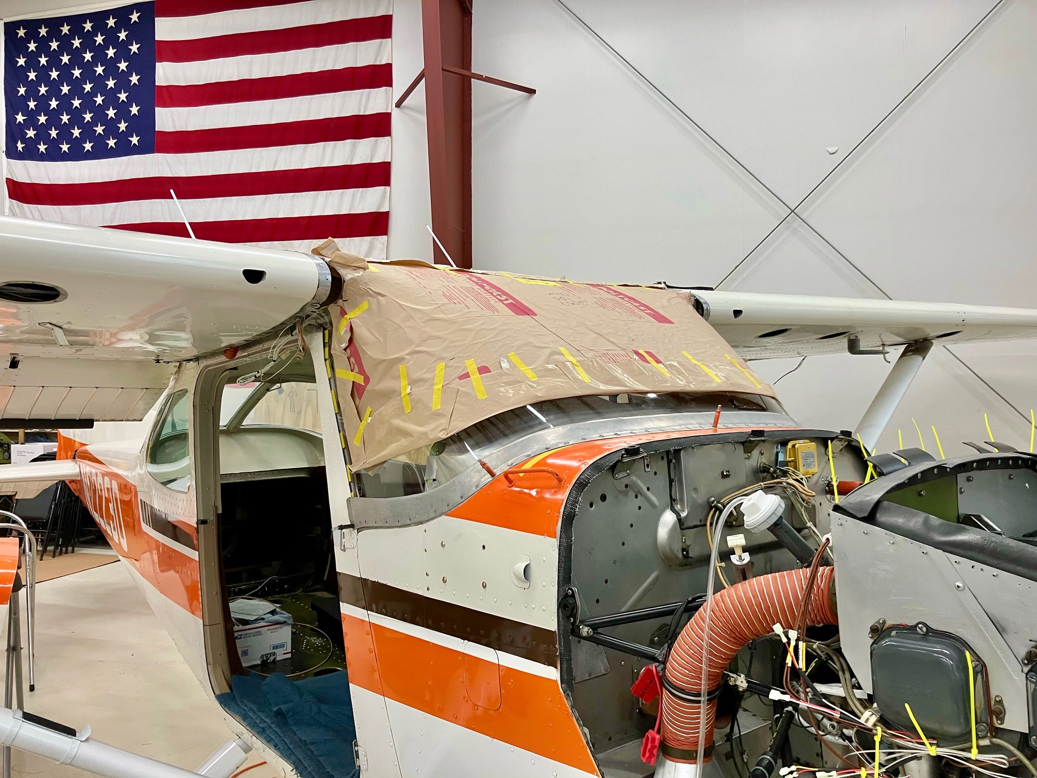

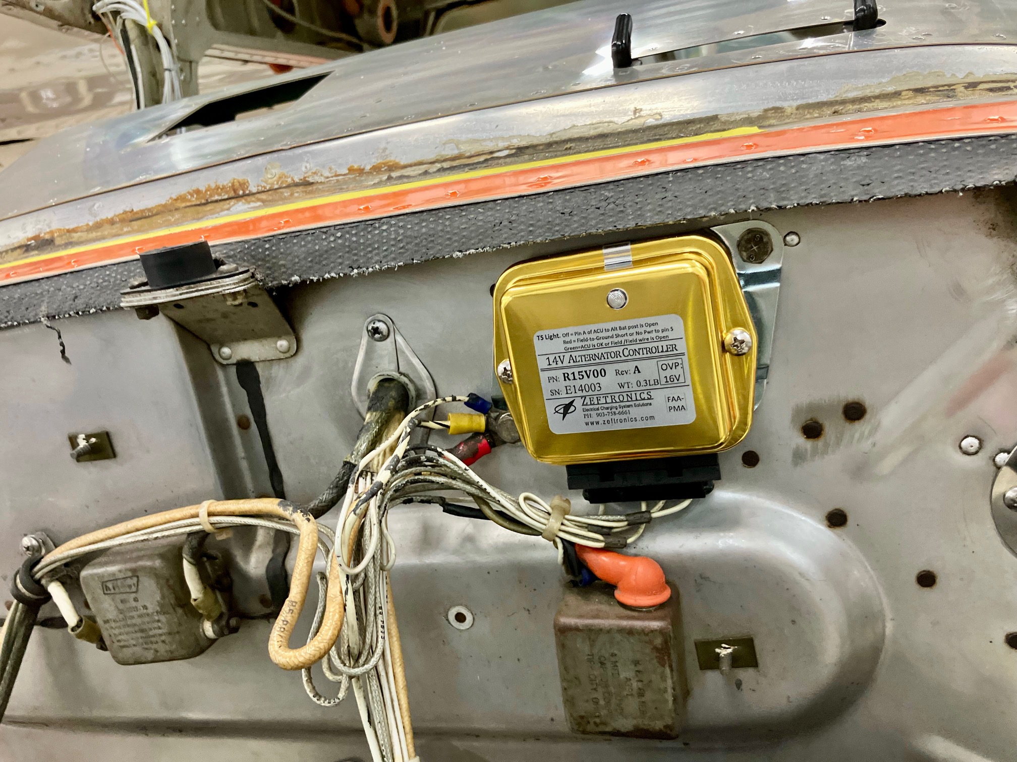

A visit today at the Six Pack Aero hangar revealed more great work in progress!

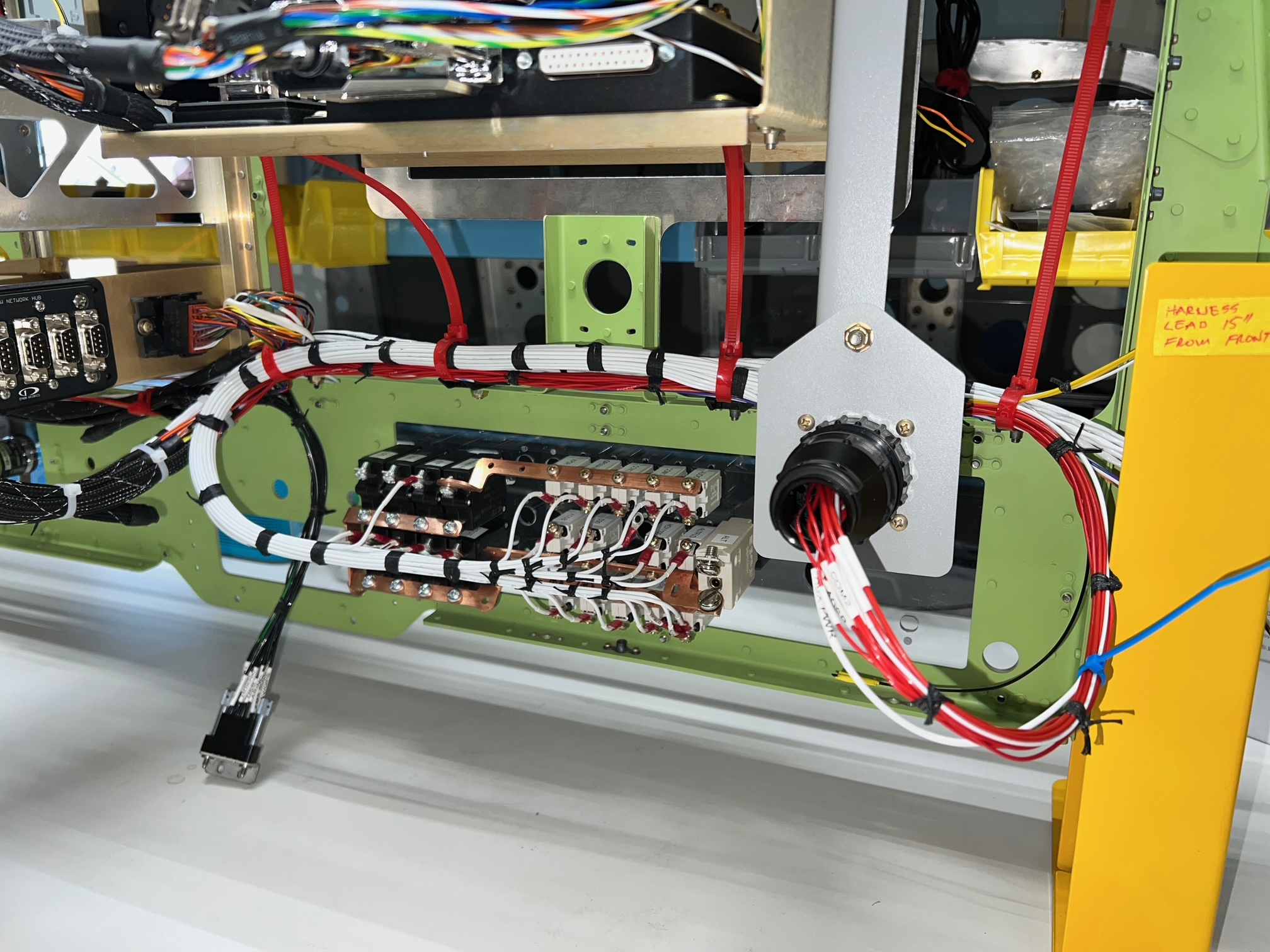

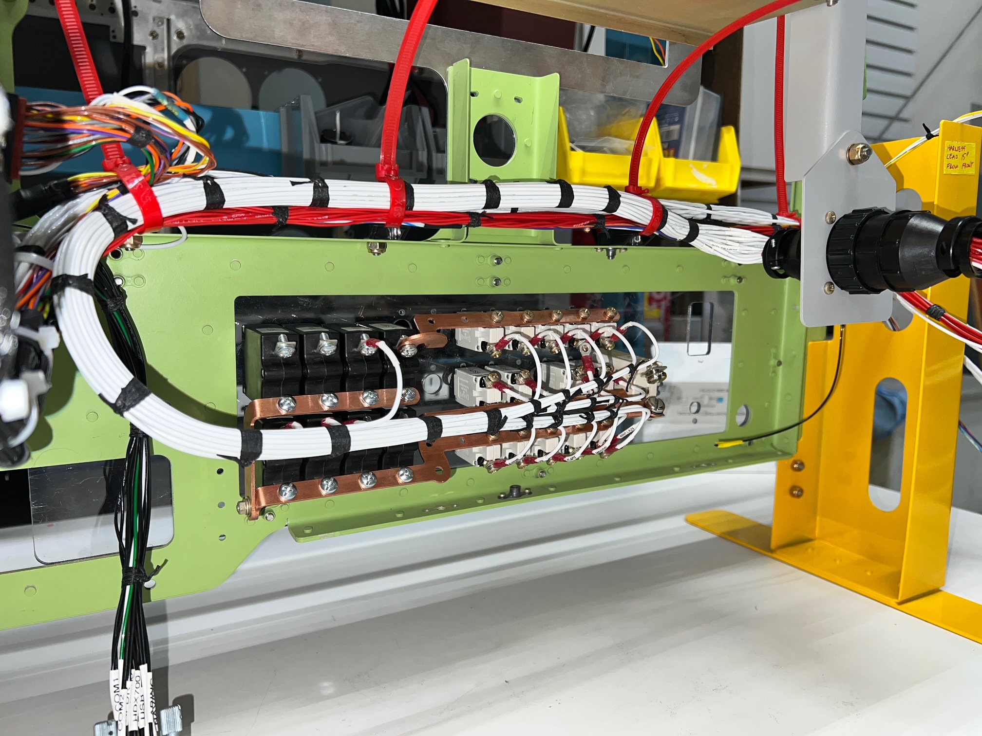

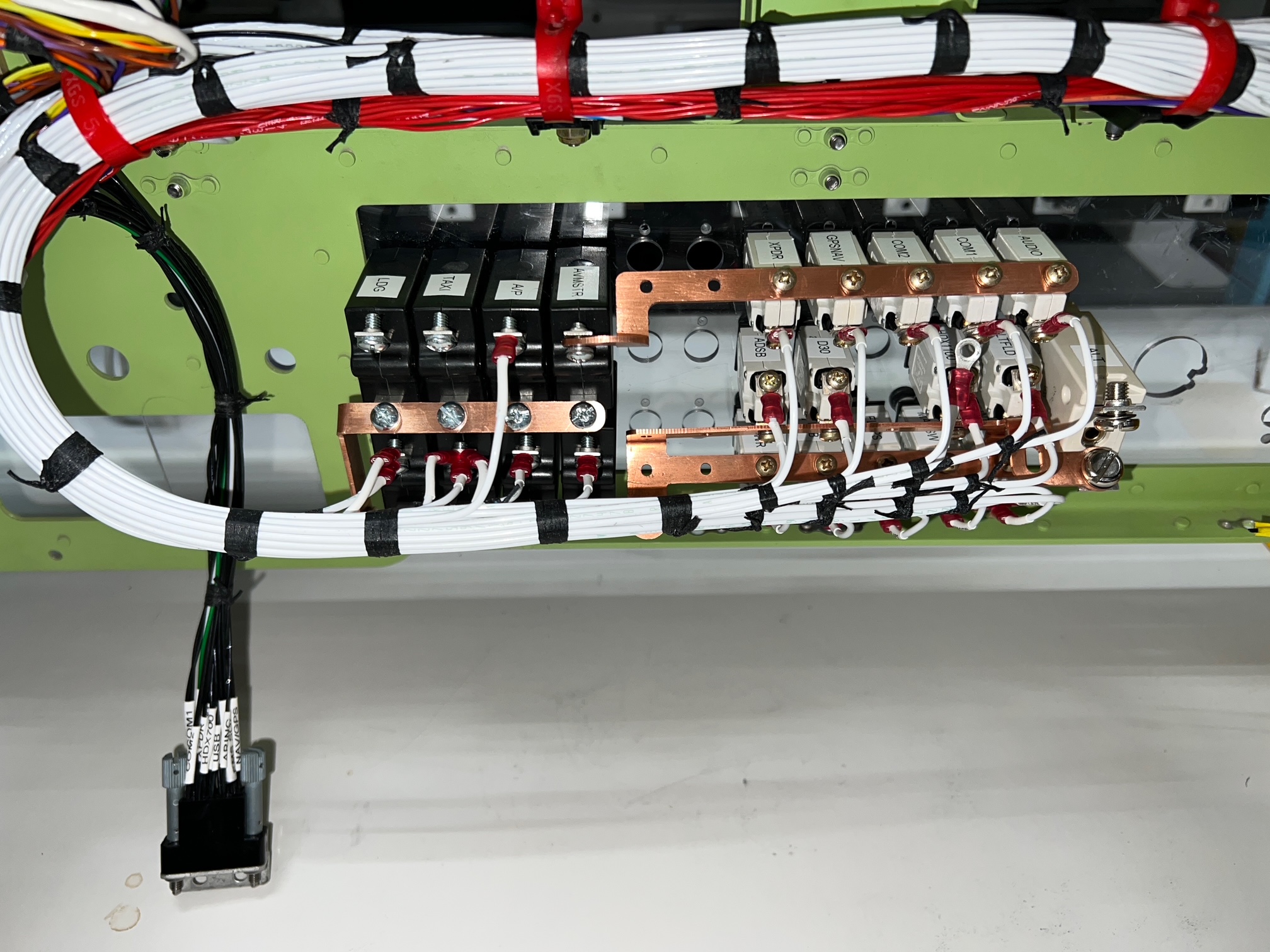

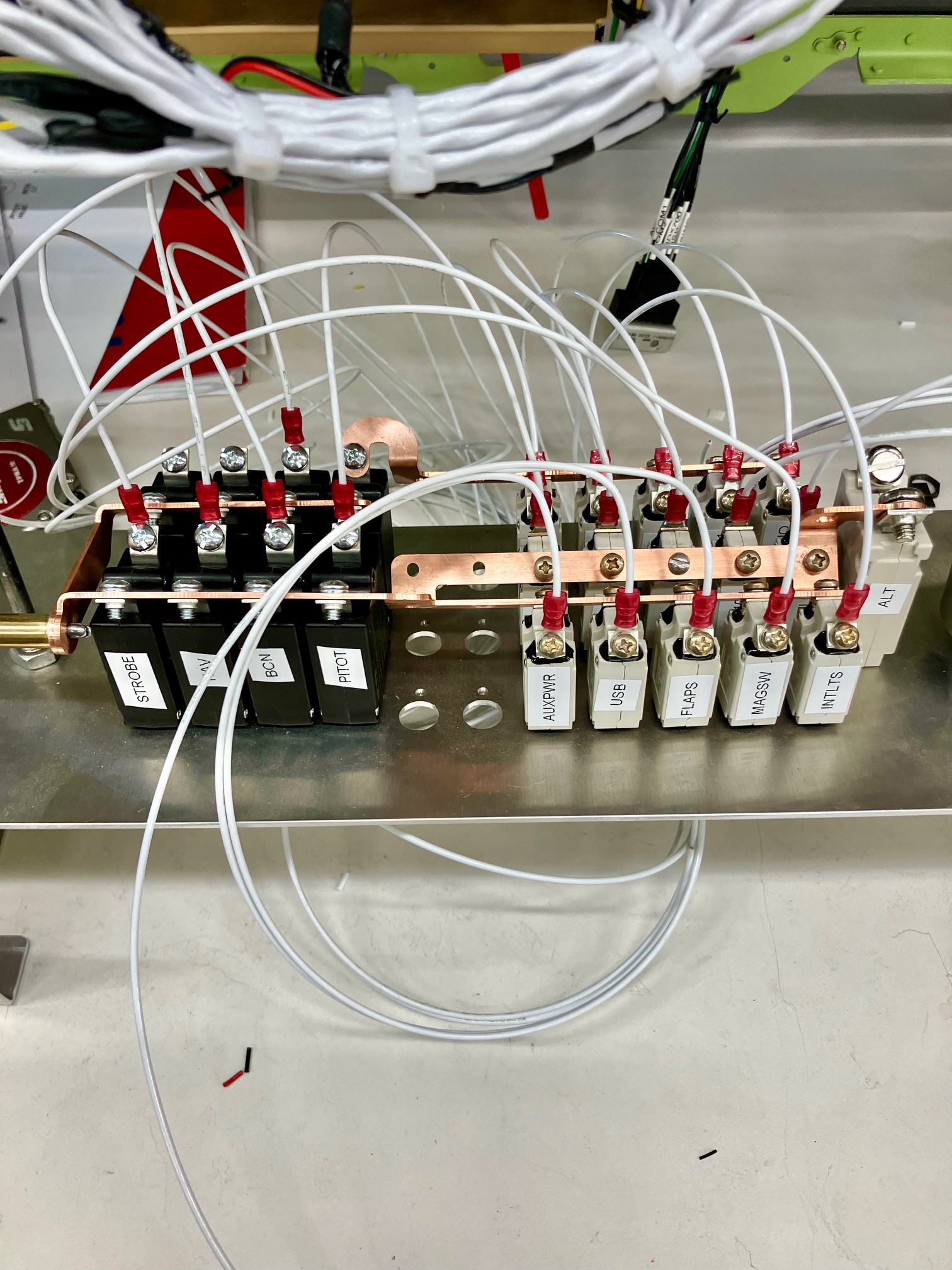

Feb 19, 2025
43
Lynden, WA
A visit today at Six Pack Aero revealed that the wiring has been completed for
the push/pull circuit breakers and control switches.
Scope out those copper buss bars!
1,183
Caution with the copper bus bars, make sure they are covered with something during install, or inaccessible from your seat. I ruined a new stainless steel coffee cup one day in my RV by letting it slip under the edge of the instrument panel and short the panel to a bus bar, notched a spot in the lower edge of the panel and took a chunk out of my coffee cup! Fortunately that was the extent of the damage, but it had my attention!
Feb 19, 2025
43
Lynden, WA
Thank you for the heads-up about this issue. I'll keep the panel area free of any stainless steel coffee mugs!
