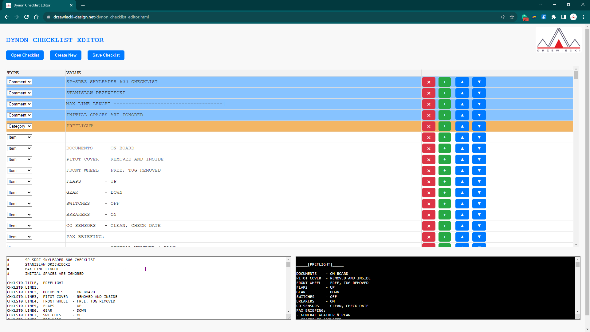

Thank you! Initially, my goal was to create a user-friendly tool for my personal use, but I'm delighted that you find it useful and believe it could benefit the community as well.
In the latest version, I've introduced a new feature: a button that allows you to toggle between using uppercase letters exclusively or not. You can switch this option on or off according to your preference.
Additionally, I've implemented automatic scrolling for the Raw Code and Preview boxes. While it's not flawless, it should now make it easier to visualize the actual changes.
Thank you for your support and feedback.

Hi! Well, I thought lowercase is harder to read in the cockpit. But there is no problem with removing that limitation. I'll do it.
The alignment should be correct. The only thing the script does is to remove leading spaces, which are ignored by Skyview. So if you have something like this:
Code:
[Before start]
Master - on
            - verify
Generator - 1 check
                    2 check
...this will be changed to
Code:
[Before start]
Master - on
- verify
Generator - 1 check
2 check
What can be done in such a case is f/e to insert a dot first, f/e:
Code:
[Before start]
Master - on
.          - verify
Generator - 1 check
.                  2 check
Using this method, you can even insert ASCII images into your checklist.

Hi guys.
I've created a web app specifically for Skyview users, making it easy to edit, change, or create checklists. This app can handle various tasks with your lists and automatically fixes numbering and other issues when you're working on an existing checklist. At the bottom of the page, you can see a preview of your checklist in both raw text and how it will look in a Skyview-equipped airplane. When you're finished, you can save your checklist to a USB drive and then transfer it to your airplane.
I've spent a lot of time manually editing my own checklists for my aircraft, and many times, it didn't work smoothly because of small coding errors. I really wish I had this tool before; it would have made the whole process much faster and easier.
