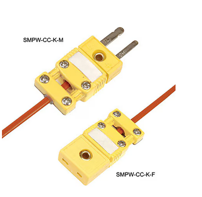

Just curious. Is there any way to safety wire those screws? Lots of vibration where they're going.
I guess a drop of loctite may alleviate this concern .
I like the look of the SMPW-CC connectors. They look like they can be screwed down/together, through the circular hole. If so this would add considerably to their security. 😈
