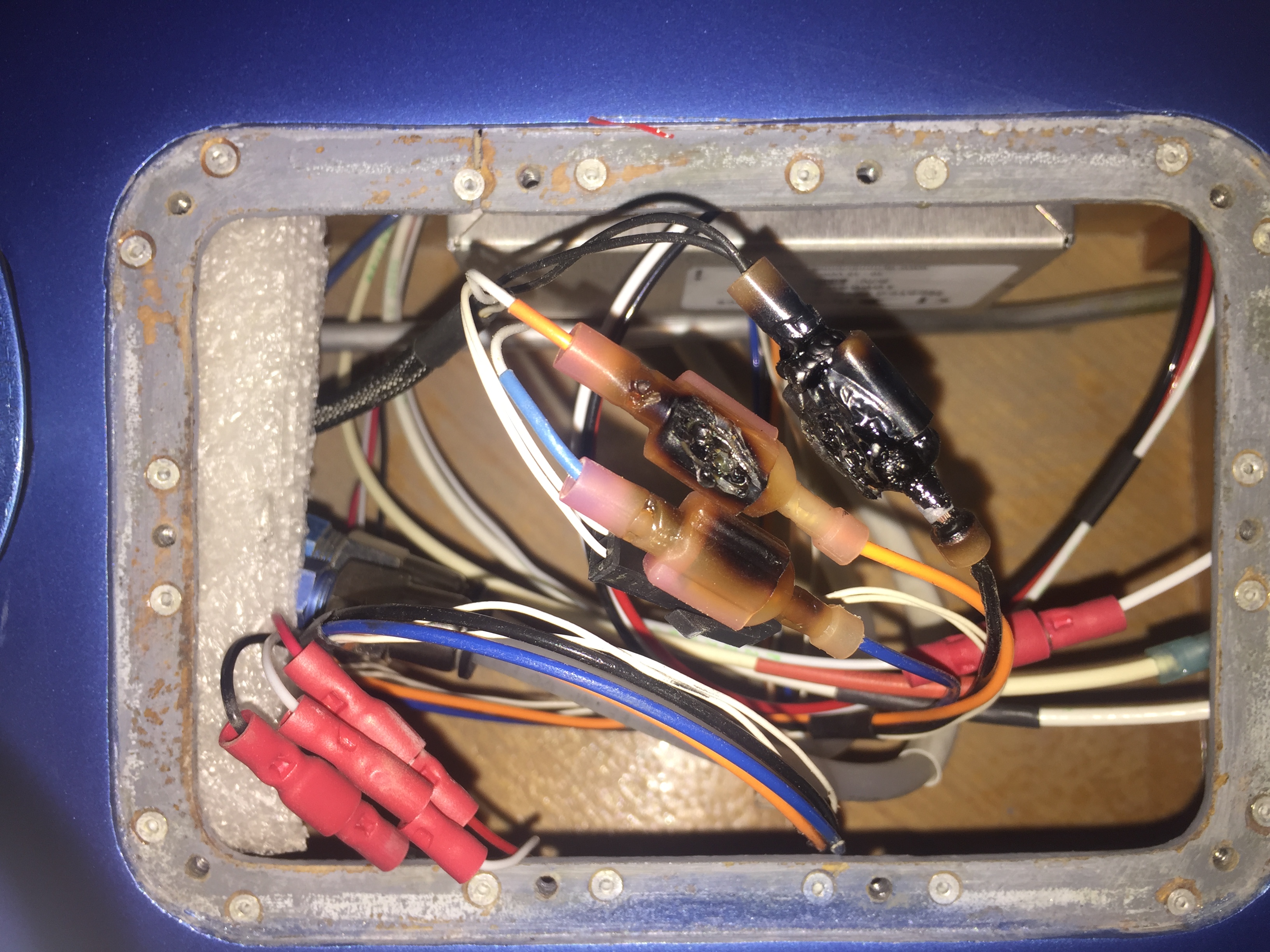

Sorry for the delay;
I think I found the source for the strange behaviour of my AOA probe. Picture attached. I suspect there was something wrong with the connector, because these are supposedly rated for much more amperage than the pitot heater takes.
If anybody has any thoughts, I'd still be interested.

Give our support team a call at 425-402-433 or email at support at dynonavionics dot com when you have a chance. We'd like to learn more about this. But fundamentally, you're correct - the currents that flow across that connector are suitable for the connector.
