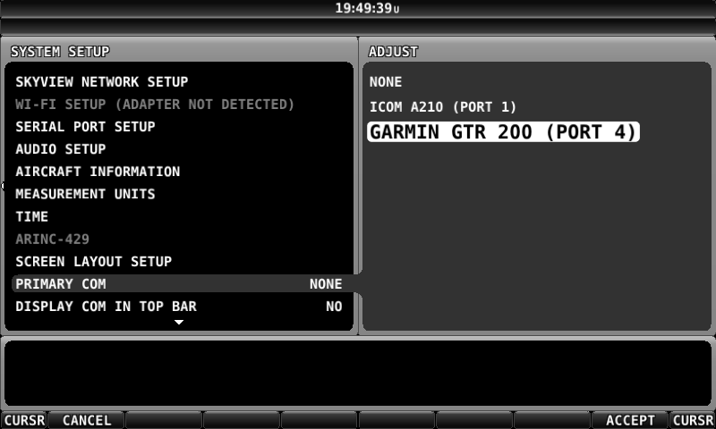

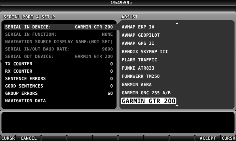

Well Bob as an expert on aviation manuals maybe this will help you understand what I mean by "bush league" for Dynon's documentation:
On page 4-20 of the Installation Guide the GTR 200 procedure is detailed.  But if you enter the set up menu on the Skyview in your airplane you will find that the choices are Garmin SL40 or "None" when picking the  radio to use.  No mention of the GTR 200 is made.  That is "bush league"....the guide was not proof read. I talked with Mike Scoffield at Dynon about this and he agreed that this should  have been better.
Hi EBB,
I wonder if you are running version 12 software because the manual on page 4-20 is correct.  The GTR 200 is one of the versions that comes up.  I can see that you could have a problem if you are running an earlier version of software and are looking at the latest documentation and it doesnt match your screen.
Here is a screen capture of the set up for the GTR-200

Here is a screen shot of selecting the GTR-200 as the primary COM.
