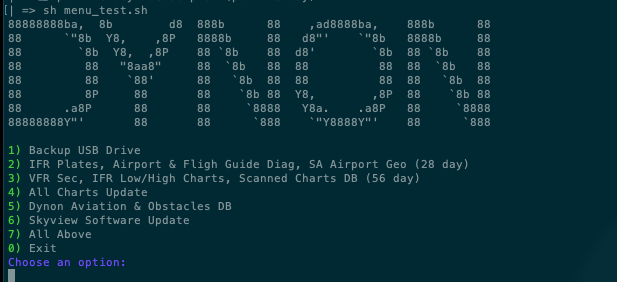

I've been working on a script that is based on this original script - but added some features, and handles Charts being on different schedules - some 28 days or 56 - at some point they have two different passwords and fold dir because of the 2 different schedules, and then I also added a bit of a menu to make it easier. Still optimizing it - and fixing a few things.

Corefile: I suspect that we may be duplicating effort, but I've finished adding in the chart downloads, error handling for the turn-of-year cycles, and software updates. I still am working on automatic handling for when the 28-day and 56-day products are out of cycle, and an efficiency update to prevent unzipping files that have already been unzipped. If you're still monitoring this thread and would like to collaborate on this, please send me a DM.
