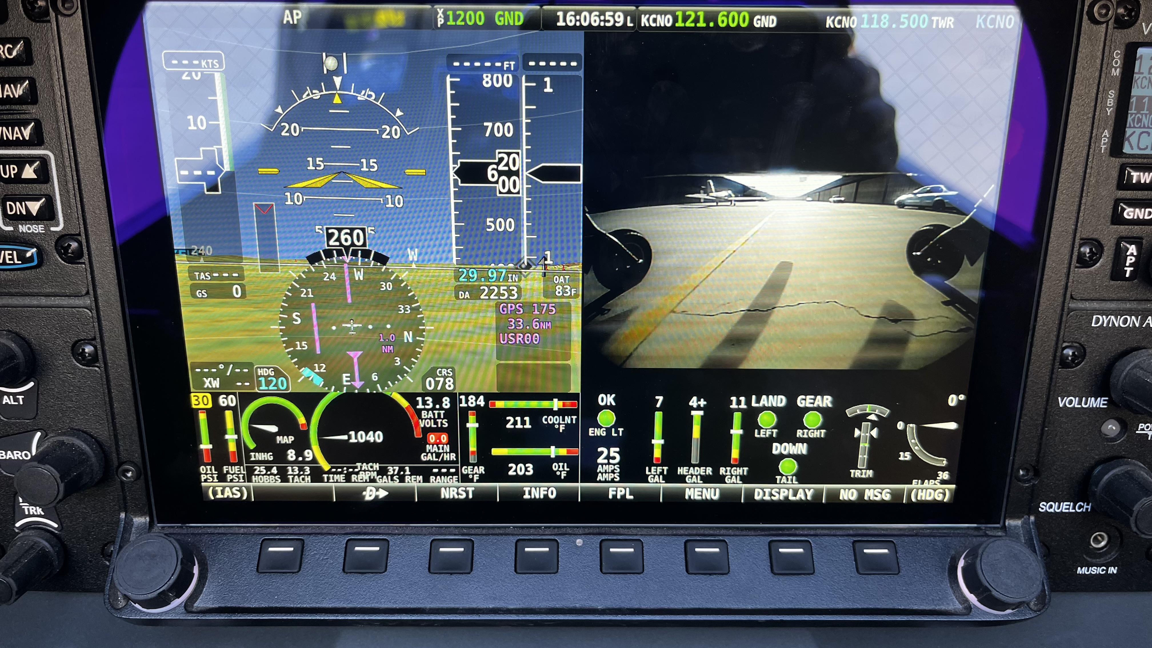

1) Ability to have a video feed from a nose mounted camera on the screen for taxiing.
2) Ability for XM
Camera located inside the air scoop of my T-51 Mustang

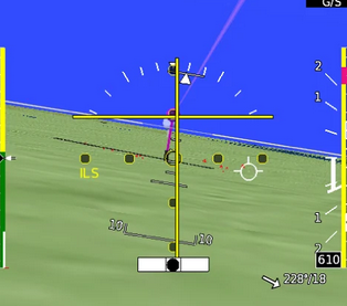

Please consider adding the option to display CDI & Glideslope superimposed over attitude indicator. It is much more intuitive than having to look elsewhere for that data. Here's a pic showing the yellow needles of an ILS:
Screenshot 2025-12-02 at 12-46-11 grt hxr.webp (WEBP Image 1257 × 954 pixels) — Scaled (67%).png
