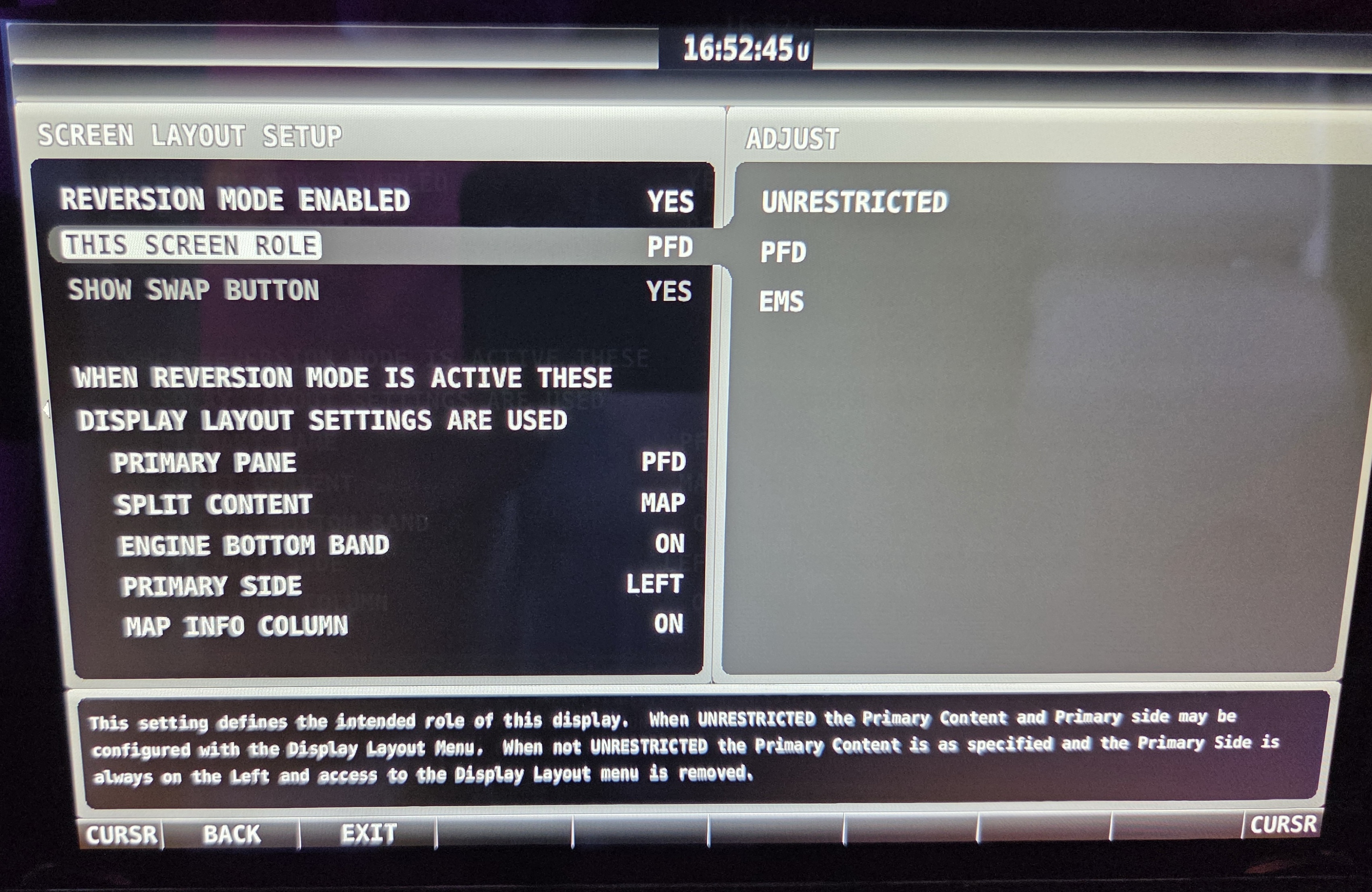

I can add some more specifics if anyone wants to dig in, I'd like to be wrong on this.
Certified installation manual rev Q section 6.3.1 states
A SkyView HDX System must have one display configured as the Primary Display. This display should be located at the position where the pilot would normally fly the aircraft. For airplanes, this is typically the left side.
To configure a display as Primary, enter the SCREEN LAYOUT SETUP menu (SETUP MENU > SYSTEM SETUP > SCREEN LAYOUT SETUP…) and configure the menus as shown in Figure 34 and described below:
1. Set REVERSION MODE ENABLED to YES
2. Set THIS SCREEN ROLE to PFD.
When in the Screen Layout setup with "THIS SCREEN ROLE" highlighted, the notes on the bottom describe what I see happening.
This setting defines the intended role of the display. When UNRESTRICTED the Primary Content and the Primary side may be configured with the Display Layout Menu. When not UNRESTRICTED the Primary Content is as specified and the Primary Side is always on the left and access to the Display Layout Menu is removed.
So if you follow step 2 of section 6.3.1, you can't get the PFD on the right side. They have all the hooks in there to allow the display to swap, but the language on the screen makes it seem like it was an intentional decision. The note in the HDX settings page about the THIS SCREEN ROLE is not in the installation manual or anywhere that I recall until the system is already installed, wired up, and turned on. The manual in section 4.3.2 specifically states that:
When considering where t place the HDX display in the instrument panel, consider that only 50% width of the display configured as the PFD must be located within the primary field-of-view.
There is no mention in the manual that it needs to be the right 50%. Too late to change the decision whether to offset the screen to the right or the left of center... This is pretty annoying and seems unnecessary and I hope Dynon changes this to allow the PFD on the right side.
For background info, I have enough panel space to have my D30 and external CDIs between the HDX and the radio stack by shifting the HDX slightly to the left. When the PFD is on the right side of the HDX, it is directly centered in front of me. Having the D30 and standby CDI's next to the GPS seems ideal in case the HDX goes dark, everything is next to each other. Smaller panels probably don't accomodate this layout, but for those that do, I'm surprised more people don't do their installation this way.

My guess is that the settings in the aircraft you flew have the "THIS SCREEN ROLE" set to UNRESTRICTED instead of PFD. Other than the legality of being per the manual, I'm not sure how much it matters in a single HDX installation. Since I only have a single HDX, I haven't looked into how the screens change when their is a failure, but I can see a requirement for ensuring a PFD is always present on one of the displays regardless which one fails. In my single HDX installation, I don't have to worry about my screen reconfiguring with a PFD in case another screen fails. I don't understand the requirement for setting the PFD role in single HDX installations or why the PFD is required to be on the left when set up that way.

It may be that I've just never seen Reversion Mode. That's definitely enabled, but I've never actually had either screen fail on me, so it may be that I've never seen that restriction in action. Regardless, the forum has done its job and caused me to seek further education on my systems knowledge. I'll have to doublecheck settings and report back on what I learn.

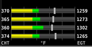

1: Allow me to press the CHT/EGT display and toggle the LoP feature.

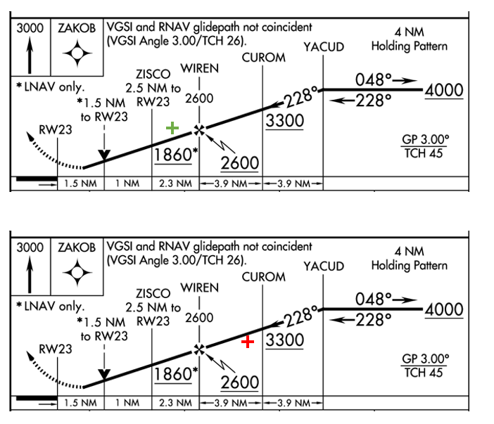

2: On the glideslope portion of the georeferenced approach plates, can you put a plus sign that indicates if you are above or below the glideslope? In this image I used a green plus sign to indicate you are on or above the GS and a red plus sign to indicate you are below the GS.
